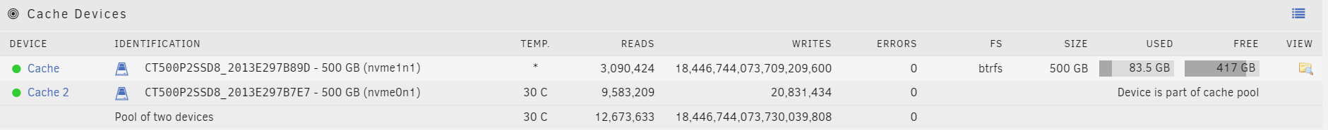

insane number of writes
I logged into my server to find one cache disk in the pool has a seemingly impossible number of  writes.
Has anyone else seen this? I attached my diagnostics in case it's helpful
flounraiddiag.zip

Crazy number of writes usually means a dropped device, and that was what happened here:
