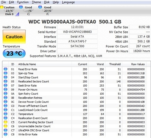

You mentioned that the SMART info showed issues (and I too like CrystalDiskInfo).  I have absolutely no reason to doubt you, and I don't know you, but I'll just make a couple of comments.  It's been my experience that most users do not know how to interpret correctly the SMART attributes and numbers.  In particular, they very often become needlessly alarmed at some of the attributes and very large numbers showing, which actually don't matter AT ALL.  In general, from a failure perspective, the only 2 things that matter are whether any attribute is marked FAILING_NOW, and whether the reallocated sector count is growing over time.  Technically, the only thing that matters is whether the WORST value (only for attributes marked Pre_fail) is decreasing over time, and especially if it is approaching the THRESHOLD value for that attribute.  Of course, you may have more experience than most, and I don't wish to impugn that in any way.  Do you mind indicating what SMART issues you saw?

I have attached a screen shot of the CrystalDiskInfo results

My respect for CrystalDiskInfo has dropped some, I thought I remembered it having tabs to check the rest of the SMART detail, such as the ATA error log, the previous SMART test results, and the ability to initiate SMART tests.  I guess I confused it with the great SMART tool on the Parted Magic live CD I've been using more frequently lately.  I wanted to check to see if those 3 problematic sectors are recent, and since I believe Uncorrectable sectors cause error log entries, you could have checked to see if they occurred recently, or well in the past.  Aside from those 3 questionable sectors, the SMART report looks very good, nothing reallocated yet.  Current Pending sectors are ones that were detected as possibly faulty, but aren't remapped or recovered until they are written to, which forces the drive to re-analyze them and either remap a spare sector in their place or accept them as good and write fresh data correctly to the sector.  There are 2 kinds of bad sectors, hard read errors are those with defective magnetic media under them (which results in them being replaced with a spare), and soft read errors are those with good media but scrambled/corrupted data.  If after testing the sector, the drive decides the media is fine, then the sector is written to, and considered recovered.  Current Pending is decreased for each sector that is tested this way.  Reallocated sectors only increases each time a sector is replaced.  The fact that you have exactly the same number of Uncorrectable sectors probably mean they are the same 3 sectors, and probably just scrambled data.  This can often occur because of a strong electrical spike while the drive was being written to, which could have occurred with a nearby lightning strike or a sudden power outage.  So chances are good that these are soft errors, and the sectors can be recovered.  But even if they are not, it is only 3 out of thousands of available spare sectors, for me a very minor issue.  The important thing is to monitor it to see if more show up.  A few once in a while is not a serious thing, unless it is the start of a bad trend.

I got the key back on the flash drive and and was able to bring all the drives back online. While it was rebuiliding the parity drive, I ran CrysalDiskInfo on the 750Gb cache drive and it is showing caution as well. I'm curious if this is actual hardware failure or just corruption. Since I'm more familiar with windows hardware tests, I started an NTFS format on it last night and plan to run a few scans that will test the hardware of the drive.
Ok, both the 750 and the 500 showed "Caution" with CrystalDiskInfo. I replaced the cache drive with a brand new 320GB drive and everything is perfect again. I then decided to shut down the server and remove each drive 1 by 1 running CrystalDiskInfo on each of them. They Parity drive is showing "Caution" as well. It's still under warranty as it is less than 1 year old so I have RMA'd it.
