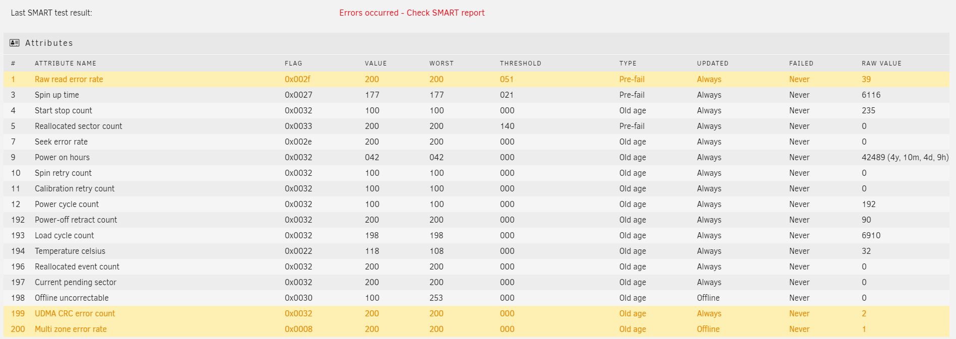

I'm having problems with one disk on my server, this disk has been marked with yellow color on SMART (UDMA CRC error count) and unraid put this disable. Well I changed the cable SATA if this is the real problem but this disk it still disabled. I have investigated this problem looking on the logs and I saw problems with some sectors so I think there's some bad sectors on it.

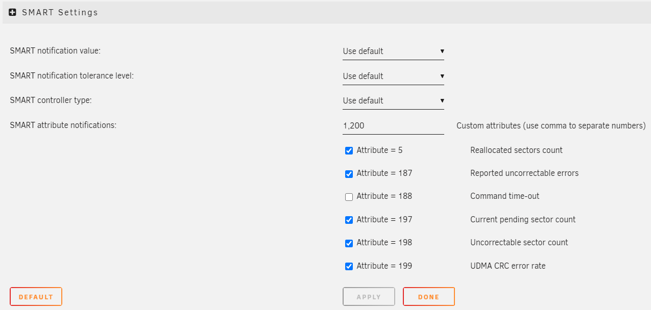

For WD Reds you should also set it to monitor attributes 1 and 200. Click on the disk to get to its settings and add those Custom attributes.
Looks like it recently passed extended SMART test, but it is showing those attributes non-zero, and syslog is showing IDNF and UNC errors.
Run another extended test.

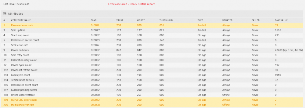

I set that like this 1, 200 on SMART attribute notifications, see the attached screenshoots and tell me if it is correct. If i run extended SMART from disk1 then you get an error inmediatly and the scan stops.
thanks.
yes
replace
