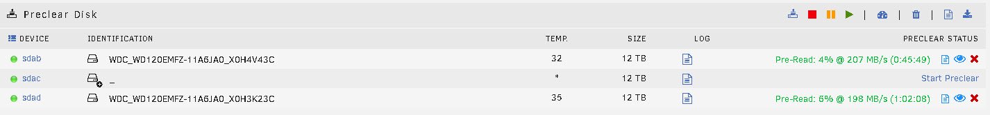

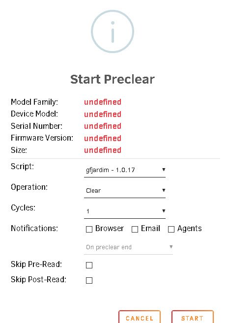

attached 3 drives to server, preclear plugin identified 2 fine, 3rd drive does not show "identity", only "_" (Attached pics)

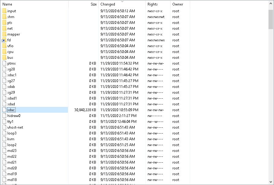

by chance ssh'ed (WinSCP) to unraid, and found that the /dev/sdac was actually a 30GB file.
Deleted the file, unplugged and replugged sata connection for that drive and VOILLA!

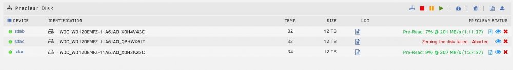

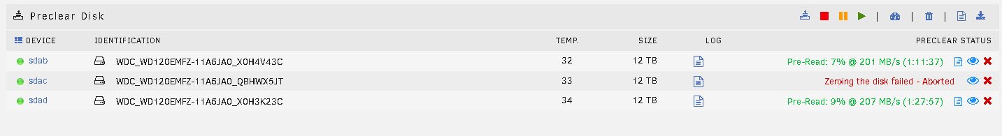

My problem must be with a bug or unhandled case in the preclear script, previously, when I was preclearing the drives, I had unplugged one of them in mid preclear...and even after attempting to stop the preclear on that drive, it must have choked on something. After wiping out that /dev file, this came up in the preclear!
