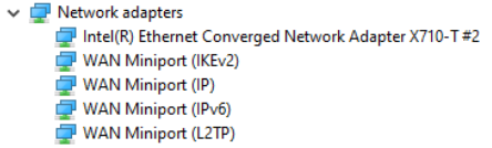

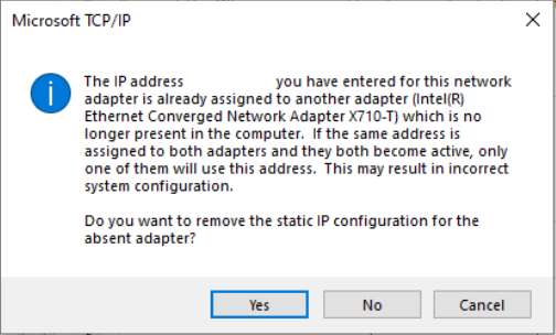

I'm having a really bad time trying to get all my stuff to work so bear with me. I have a Windows 10 VM that I'm trying to get working. I have an Intel X710-T4 passed through to a Windows 10 VM. When I pass through either the USB controller or the Titan RTX, then the networking works fine. But when I pass through both the GPU and the USB controller the networking breaks. I can see that the link is up and the NIC is detected correctly but the VM can't transmit any data. Sometimes I get the attached message and the NIC shows up with a "#2" at the end of the name in Device Manager. I haven't touched the NIC passthrough so I don't understand what is happening. Assistance would be greatly appreciated.

When I set the GPU to be the primary graphics card, Windows detects the NIC as if it were a different device even though the NIC has the same MAC address. The NIC shows up in device manager as the correct model but it has a #2 or #3 appended to the end. Windows also dumps the static IP I set because it thinks it has a different NIC.
