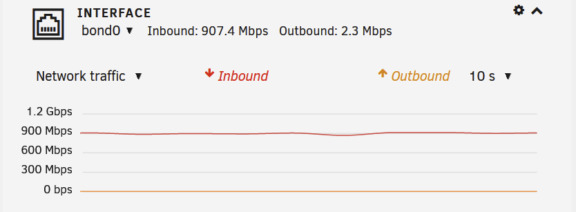

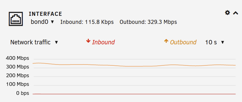

I've been encountering some weird performance issues with 6.10.0-rc2.
I'm using 1 Gbit/s connections both with my Unraid server and my Desktop PC.
This is what it looks like transfering a file from my Kingston A2000 in my Unraid server to my Desktop PC (this is via FTP; the same goes for SMB):
This is what it looks like transfering a file from my Desktop PC to my Unraid server via FTP (the same goes for SMB):
This is almost 3x faster, which should not be the case given that it's a working 1 Gbit/s connection to my router and going from my router to my Desktop PC.
