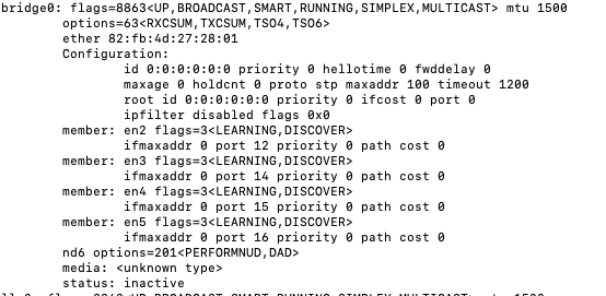

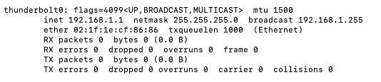

    2.I can manually use "ifconig thunderbolt0 IP up" to assign ip and activate the interface
    but it's still not showing under the gui "network settings"

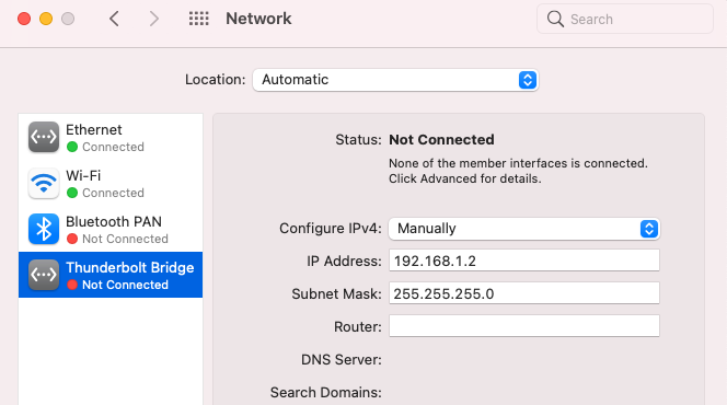

    3.after doing the above manually, my Mac see Tower under system report
    but it won't connect even after giving the thunderbolt static ip in same subnet
    (tower is 192.168.1.1 and Mac is 192.168.1.2 which is different from my router pool)
    so in the end, network isn't working
    attached unraid diagnostics, ifconfig output from tower and relevant mac settings

    Hi
    I can bypass 1, by changing bios settings to not secure or by using what you suggested
    I can bypass 2 by editing network.cfg and adding this lines
    IFNAME[1]="thunderbolt0"
    IPADDR[1]="192.168.1.1"
    NETMASK[1]="255.255.255.0"
    USE_DHCP[1]="no"
    SYSNICS="2"
    but the end result is the same :(
    it looks fine on unraid end, but the mac won't connect

    I created /etc/udev/rules.d/71-persistent-net.rules
    [email protected]:~# cat /etc/udev/rules.d/71-persistent-net.rules
    # Thunderbolt
    SUBSYSTEM=="net", ACTION=="add", DRIVERS=="?*", ATTR{address}=="02:1f:1e:cf:86:86", ATTR{dev_id}=="0x0", ATTR{type}=="1", KERNEL=="eth*", NAME="eth10"
    and still network doesn't work after these:
    udevadm control --reload
    udevadm trigger --action=add --attr-match=address="02:1f:1e:cf:86:86"
    any help will be appriciated

    Hi @SimonF
    I had it wrong before, didn't replace KERNEL=="eth* with KERNEL=="thunderbolt*
    now I get eth10/3 (doesn't seem to matter) in ifconfig and Unraid network settings
    I still can't get the connection to work though.
    with Ubuntu for example, I set static IP (different from my DHCP range)
    for example - server 192.168.1.2 an PC 192.168.1.3 and that's it
    now after setting it, no connection (can't ping either)
    I'm on mac (as you can see from the output before which is strange cause it's detecting my mac with 20GB/s link)
    Link to comment
    Just a little update
    on windows it's ( kind of) work
    I can establish 20gb/s link but the real transfer speed is ridiculous (less than 10mb/s)
    will continue testing
    Thanks
    Link to comment
    Another update
    when using Windows 10 - it doesn't matter if the device is eth* or thunderbolt*
    I can establish connection (shows as 20gb/s) but it's not reliable
    from pc to tower link is very slow, few mb/s
    from tower to pc it's not as fast as it should be but it's better +/- 4gb/s
    not matter if coping file or using iperf3 (one time as client and other as server)
    maybe it's a driver issue...
    when switching to mac os - still can't establish connection (although my mac is recognized in tower)
    tower booted with ubuntu instead of unraid:
    with windows same behaviour
    with mac os - full speed both ways
    out of ideas :)
