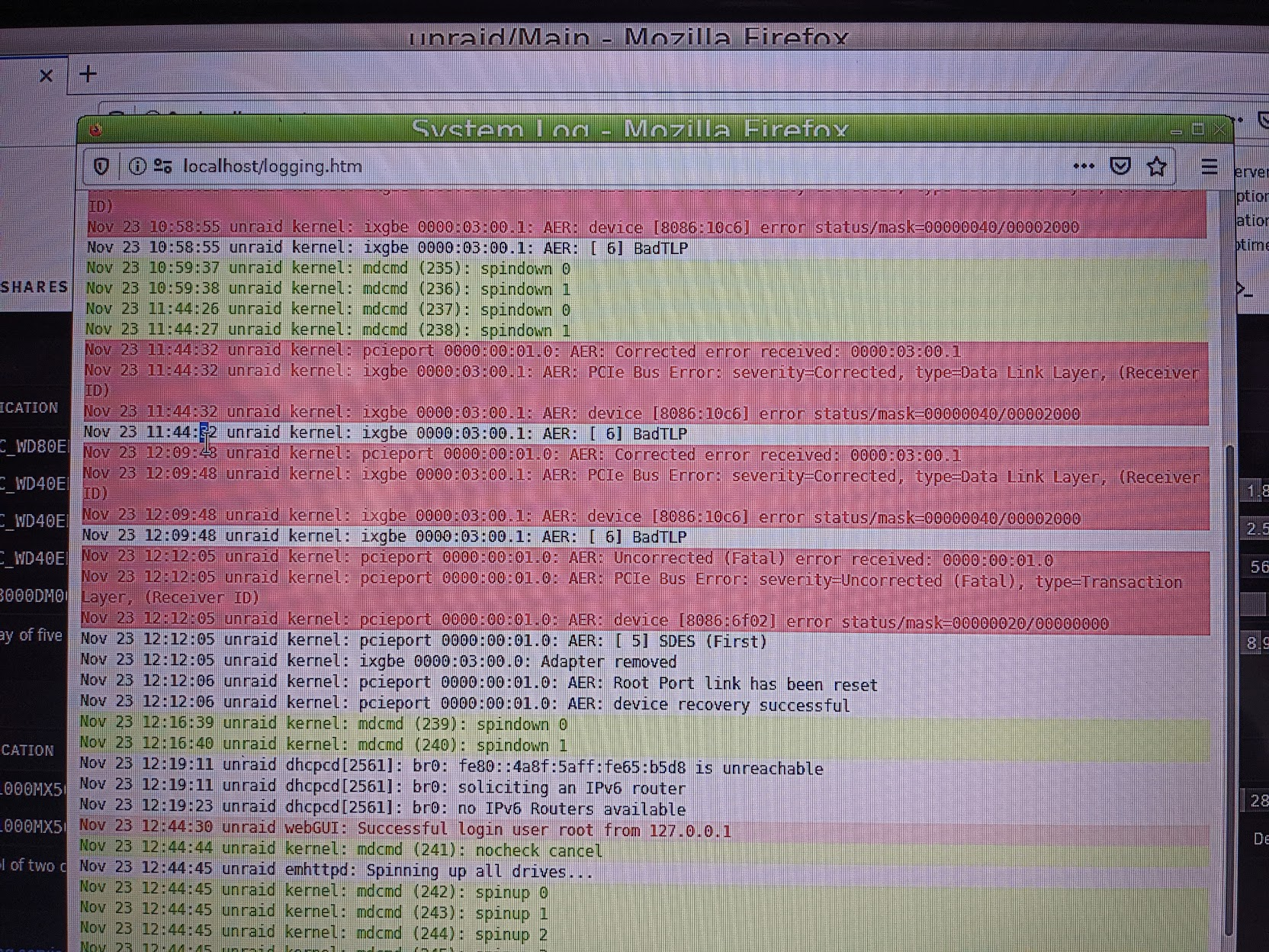

My unRAID 6.9.0beta35 (required as I'm running Nvidia acceleration) keeps having issues with the intel dual-port XFP card which is installed.  This card uses the ixgbe module.  The behaviour is that the machine loses network connectivity.  Link lights stay up but the OS unloads the module.
I get these errors which happen frequently. If they self correct it keeps going but if it fails with a fatal it requires a reboot:
Nov 23 13:04:30 unraid kernel: pcieport 0000:00:01.0: AER: Corrected error received: 0000:03:00.1
Nov 23 13:04:30 unraid kernel: ixgbe 0000:03:00.1: AER: PCIe Bus Error: severity=Corrected, type=Data Link Layer, (Receiver ID)
Nov 23 13:04:30 unraid kernel: ixgbe 0000:03:00.1: AER: device [8086:10c6] error status/mask=00000040/00002000

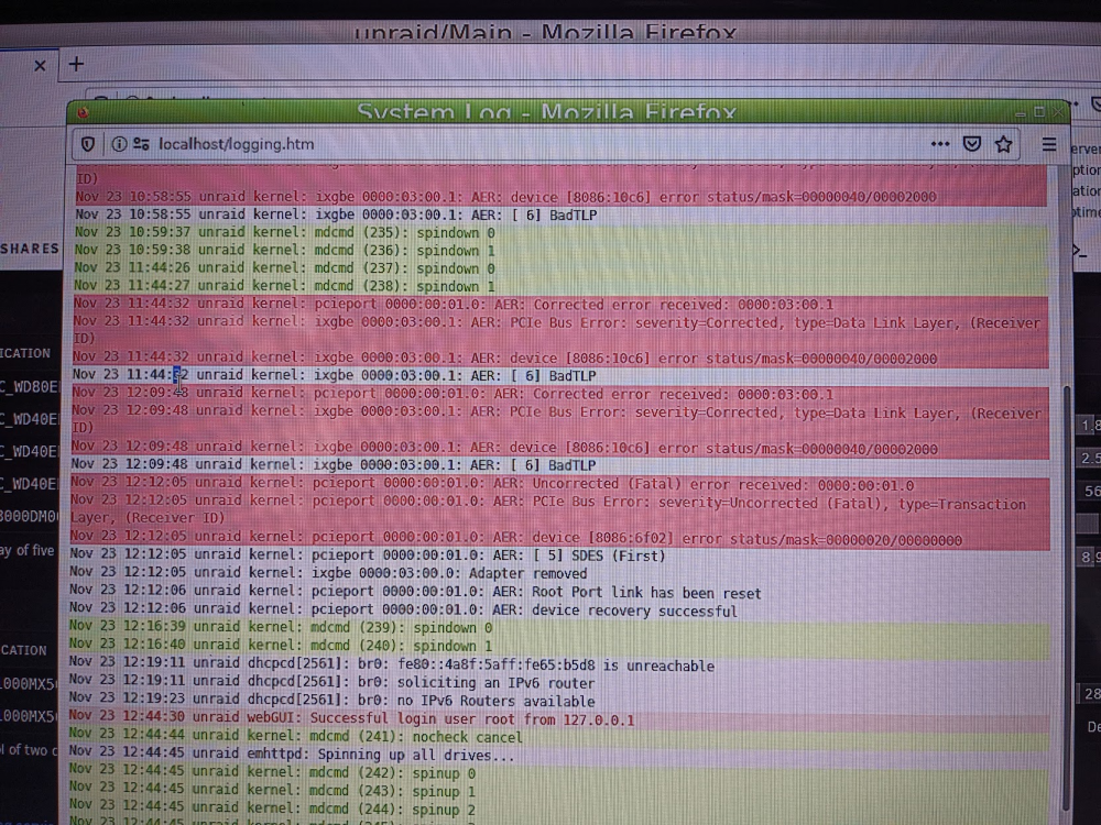

I only have an image of the fatal error unfortunately rather than text.image.thumb.png.432ab8208d16044a3b2c8e6397ca9d34.png
