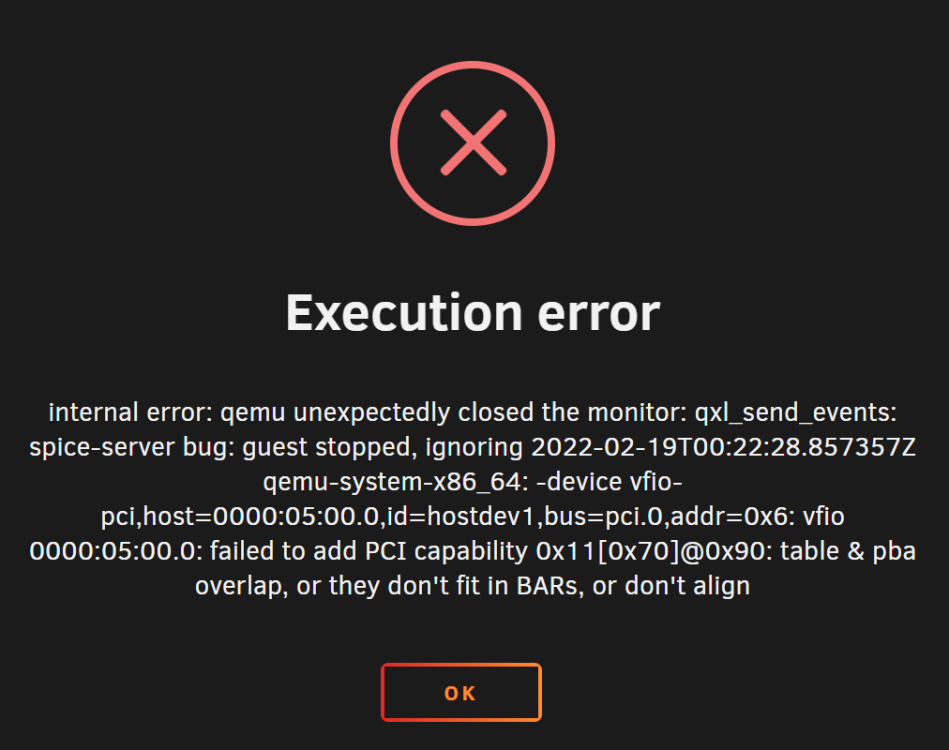

I had trouble getting this Wifi card to work with an error message referencing hostdev1 or something not fitting in BARs.
I searched, I posted, I got a great answer from Ghost82 who translated the info I had found into the xml:

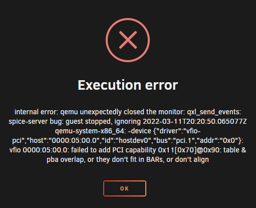

First the VFIO passthrough changed in System Devices, and then after I re-enabled that it still would not boot the VM.
But now it doesn't refer to any hostdev id... it refers to it as bellow
If I remove the Wifi card the 2 NIC ports get alias' lines, but if I add the Wifi card back in nothing does.

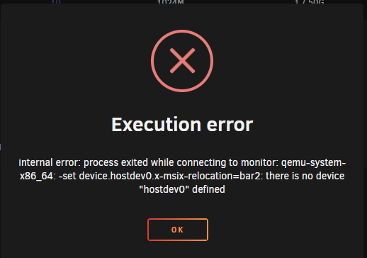

If I edit the xml to give the Wifi card an alias and put the comandline part back in.
WIFI Added with Command.txt
I get an error claiming there is no hostdev0
and when I look back in the XML the alias' are all gone.
