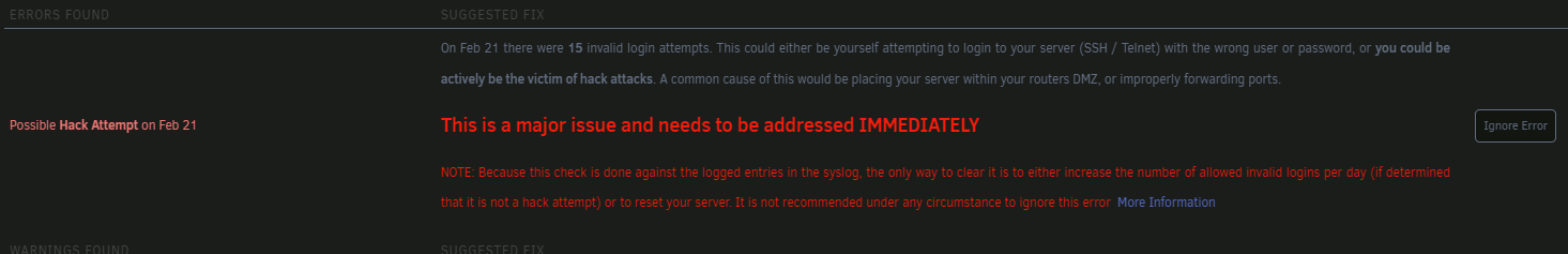

I had to reboot my server recently, and I received a `Possible Hack Attempt` notification from a plugin called `Fix Common Problems'.

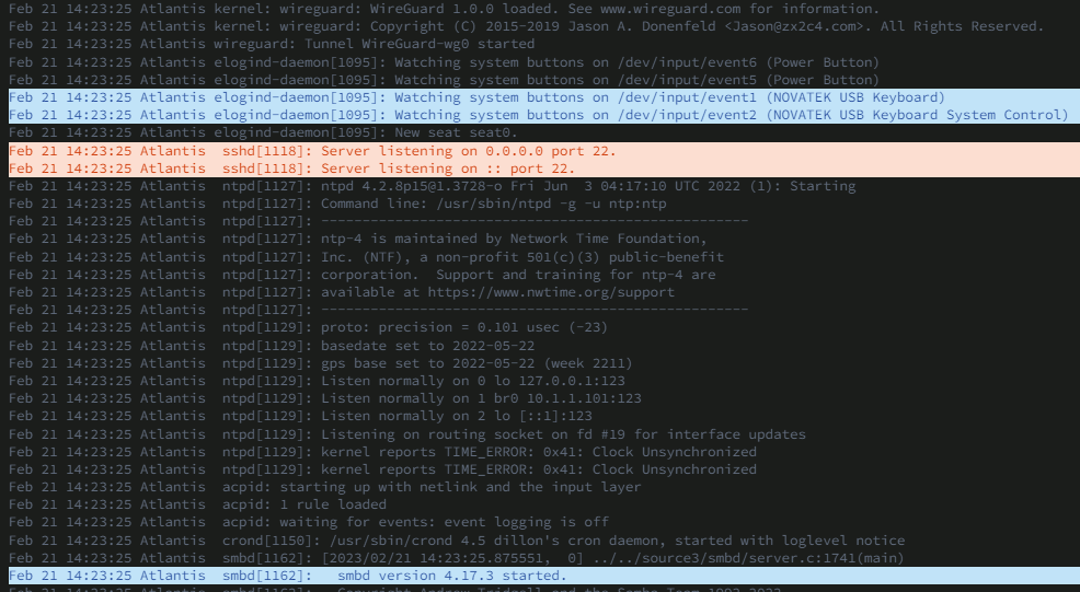

SSH being started with port 22:

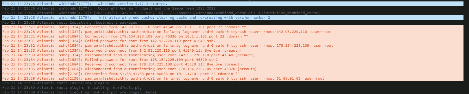

SSH login attempts being made during this window of opportunity:
There's more than just those.

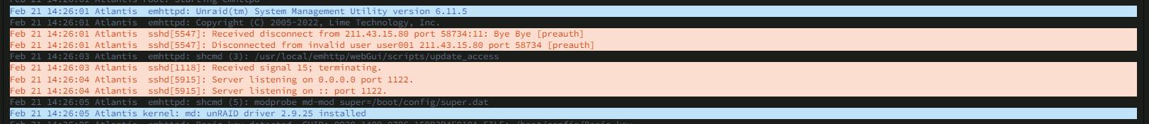

SSH being restarted with the correct configuration:
