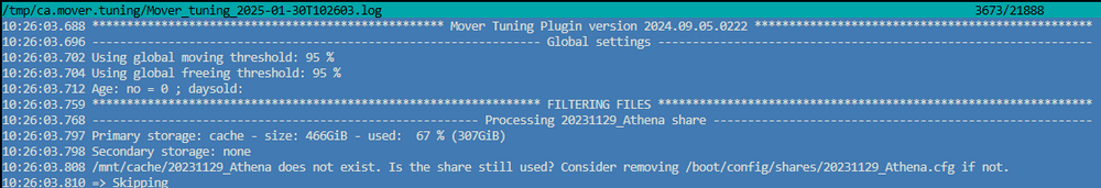

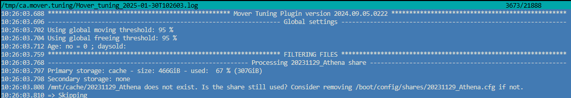

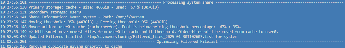

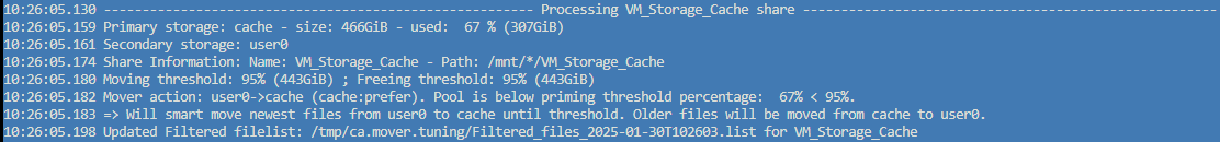

  1. Mmm, and the job files say the smart move is being used, even though that setting is off. I've uninstalled the plugin for now, and the mover works without screwing my ram over. My suggestions for plugin development with my experiences so far would be: Make sure the settings are being read and used. I'm not confidant they are currently. Offer storing the files in tmp on alternative storage, such as the cache or array. While ram is a great place for active files, it's able to starve out other processes and trigger the OOM. I'll add some screenshots from the last run (which I had to cancel), but as is it's not safe to run the plugin with the OOM risk.
  2. Were you responding to another message other than my own? Mine was referring to files created that were filling up the ram.
  3. It should be affecting your ram, unless you have tmp pointed to your cache.
  4. I'm finding even with "Log Mover Tuning plugin actions" set to no, that it's logging to `/tmp/ca.mover.tuning`. The problem file is `Filtered_files_`*, which grows and grows, using up a large amount of ram, eventually triggering OOM.
