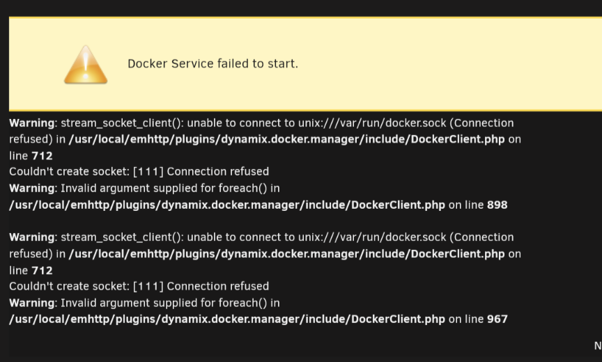

  2. ok, so I tought I was out of the woods (I might look at portainer later) but, I'm not... in the docker tab of the gui I get this: Warning: mkdir(): Input/output error in /usr/local/emhttp/plugins/dynamix.docker.manager/include/DockerClient.php on line 351 I have access to some of the files on some shares but the one that has most of my stuff there's nothing showing (even if the data is actually there). If I sttop the array and start it again then I have access to the files, I've not started dockers yet but if it does the same as last time it'll work for a few hours then go away (I'll start dockers again in a few minutes and see). edit: the cache drive says unmountable... (are we getting somwhere there?) vault-diagnostics-20230517-1004.zip
  3. ok, so it seems to work... I managed to delete a crap ton of stuff from the appdata share (old docker that were not even actually installed). then I restarted the server with docker off and then I started it and it seemed to work so I performed a scrub and in an other tab I was looking at my ram usage, it was way down from before so I removed some dockers that I was keeping stopped but never used and I seem to have my things working reliably now. I will definitely be upgrading my ram soon and set a daily backup to an external device as well as on the system using ca backup appdata... thanks for the help
  4. I had did that previously and did it again and it didn't work. At firt it seems like it does you see the dockers but if I go in a different tab and come back I get the same message as the screenshot and I got the memory error message in the fix common problems plugin. Could it be that I'm running out of ram to boot as many docker as I have? Attached new diag files just in case vault-diagnostics-20230511-0625.zip

  6. So, I may have answered my own thing... I found this Docker corruption. Could anyone confirm that this is the case and I have a lot of work in front of me to recreate something that I have no backup of (yeah I know I should have that but I don't, I'll make sure I do in the future). Also, weird thing I can access my plex library...
  7. Ok so, docker fails to start, I tried rebooting with docker disabled let the server start then enable it because I also got a server out of memory error (which doesn't appear anymore but the diag files were made when it did, I can produce new files if needed) but to no avail. Now I just don't know what to do... I've added the diagnostic files and a screenshot of what appears when the docker tab is open after failing to start Thanks to anyone who can help vault-diagnostics-20230510-1752.zip
