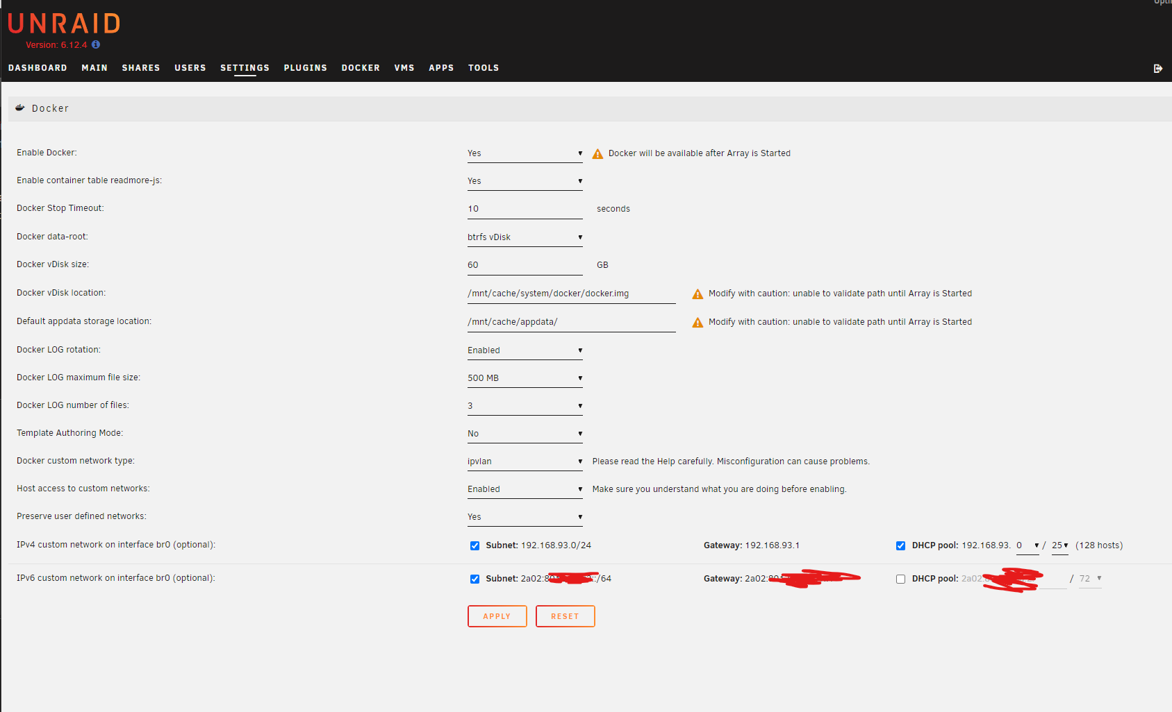

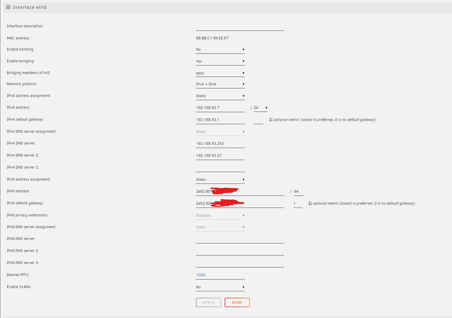

Upgraded from 6.12.3 and having issues with my dockers using custom ipv6 addresses. I'm getting this error:
docker: Error response from daemon: user specified IP address is supported only when connecting to networks with user configured subnets.
These are the settings which worked fine on 16.12.3:
docker run
  -d
  --name='binhex-sabnzbd'
  --net='br0'
  --ip='192.168.93.193'
  --ip6='2a02:restofip'
  -e TZ="Europe/London"
  -e HOST_OS="Unraid"
  -e HOST_HOSTNAME="tower"
  -e HOST_CONTAINERNAME="binhex-sabnzbd"
  -e 'TCP_PORT_8080'='8080'
  -e 'TCP_PORT_8090'='9090'
  -e 'UMASK'='000'
  -e 'PUID'='99'
  -e 'PGID'='100'
  -l net.unraid.docker.webui='http://[IP]:[PORT:8080]/'
  -l net.unraid.docker.icon='https://raw.githubusercontent.com/binhex/docker-templates/master/binhex/images/sabnzbd-icon.png'
  -v '/mnt/disks/WDC_1TB_BLACK/Sab':'/land':'rw,slave'
  -v '/mnt/cache/appdata/sab/':'/config':'rw' 'binhex/arch-sabnzbd:latest'
366a3580aae5540d218ef2281456d083994bf8f7998a1cb51b05e378cd705ad6
Am I missing something? Going to have to roll back for now. If i remove the specified IPv6 Address it works fine.
Please let me know where to send diagnostics don't want to post them publicly.
