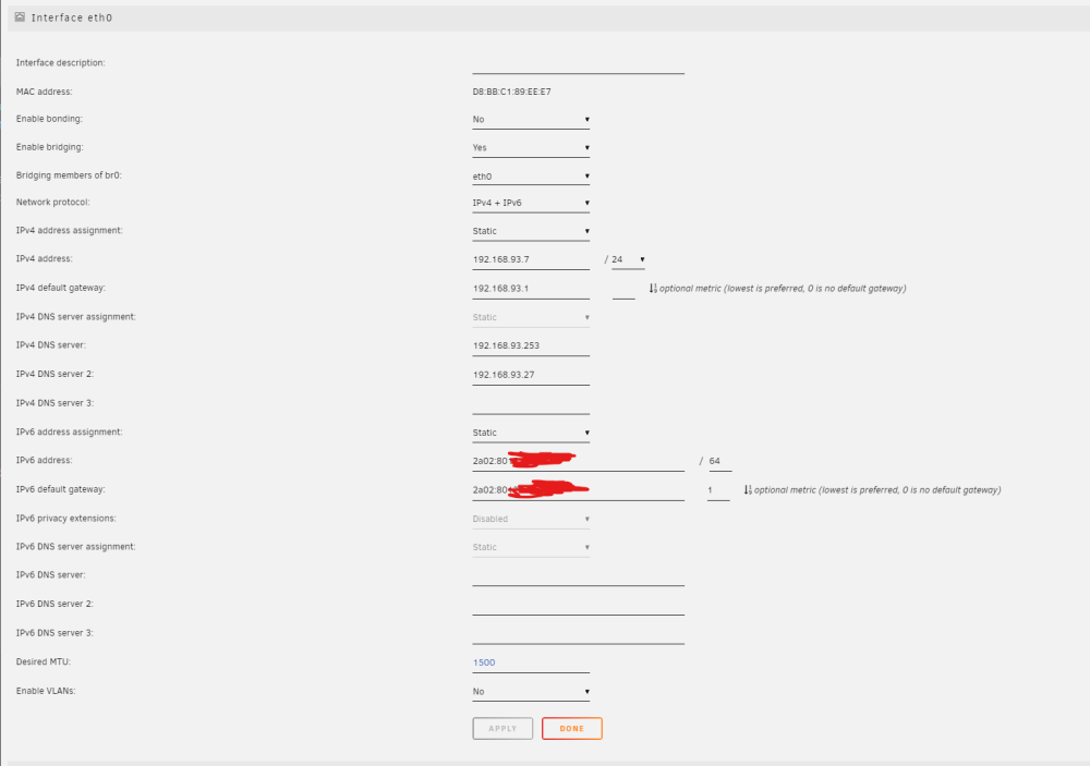

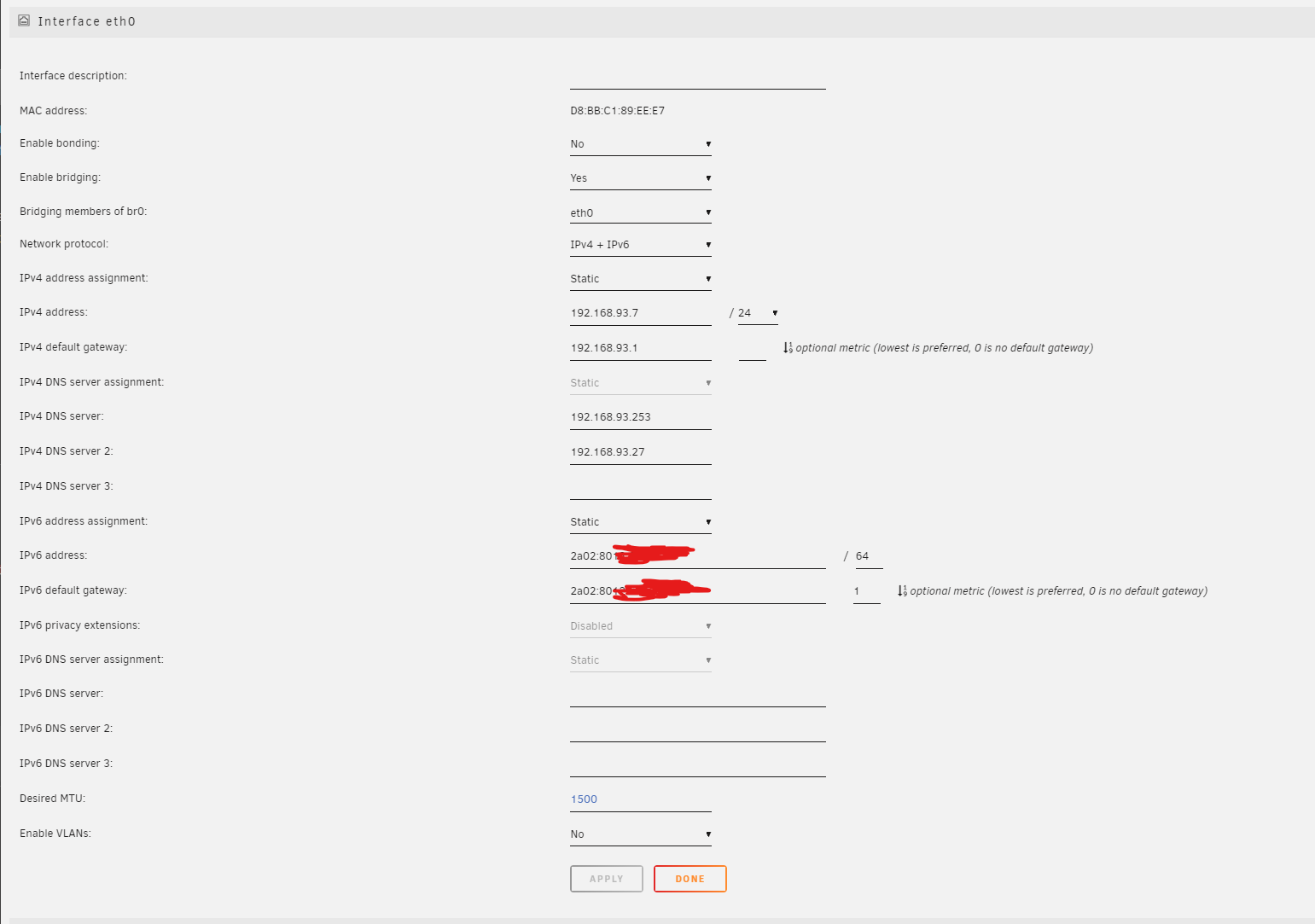

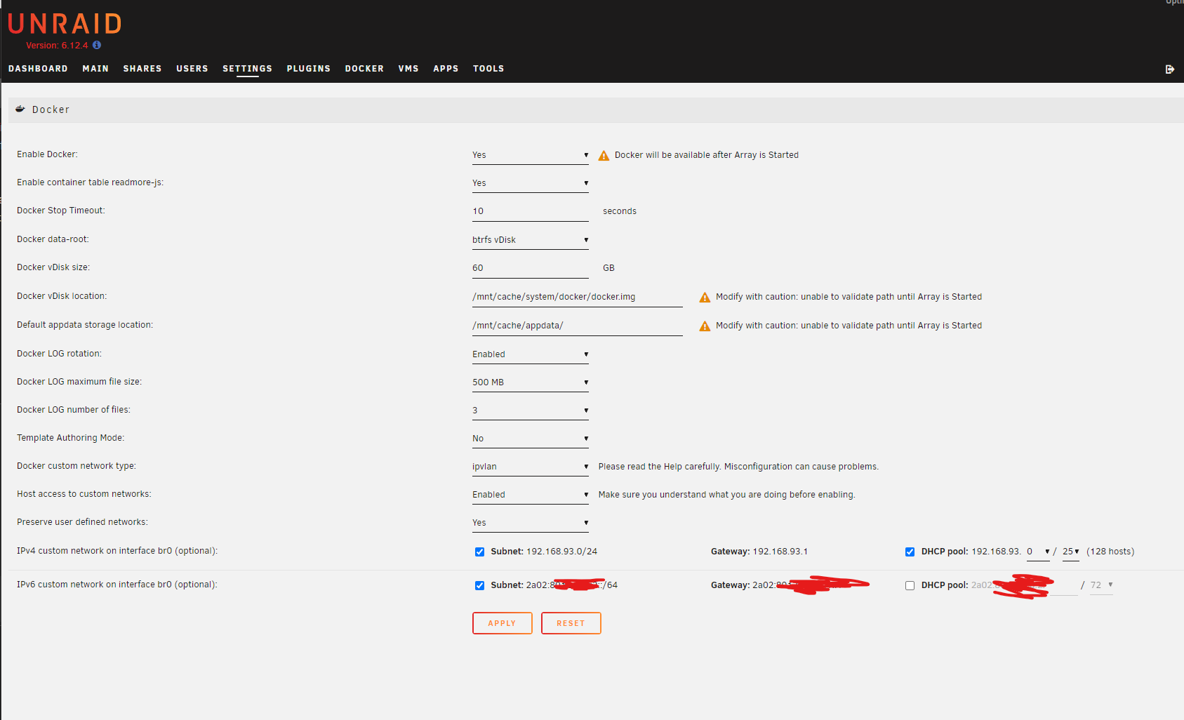

  4. Hi, It seems that the anonamise doesnt work as expected. Its not removing LOCAL_TLD from ident.cfg so if people are using custom hostnames/dns they could be exposed. Its also not removing IPv6 addresses. So again if people are using routable IPv6 address they are potentialy being exposed. This is in network.cfg and in logs syslog ext. Thanks, Daniel
  5. Hi, Upgraded from 6.12.3 and having issues with my dockers using custom ipv6 addresses. I'm getting this error: docker: Error response from daemon: user specified IP address is supported only when connecting to networks with user configured subnets. These are the settings which worked fine on 16.12.3: docker run -d --name='binhex-sabnzbd' --net='br0' --ip='192.168.93.193' --ip6='2a02:restofip' -e TZ="Europe/London" -e HOST_OS="Unraid" -e HOST_HOSTNAME="tower" -e HOST_CONTAINERNAME="binhex-sabnzbd" -e 'TCP_PORT_8080'='8080' -e 'TCP_PORT_8090'='9090' -e 'UMASK'='000' -e 'PUID'='99' -e 'PGID'='100' -l net.unraid.docker.managed=dockerman -l net.unraid.docker.webui='http://[IP]:[PORT:8080]/' -l net.unraid.docker.icon='https://raw.githubusercontent.com/binhex/docker-templates/master/binhex/images/sabnzbd-icon.png' -v '/mnt/disks/WDC_1TB_BLACK/Sab':'/land':'rw,slave' -v '/mnt/cache/appdata/sab/':'/config':'rw' 'binhex/arch-sabnzbd:latest' 366a3580aae5540d218ef2281456d083994bf8f7998a1cb51b05e378cd705ad6 docker: Error response from daemon: user specified IP address is supported only when connecting to networks with user configured subnets. Am I missing something? Going to have to roll back for now. If i remove the specified IPv6 Address it works fine. Please let me know where to send diagnostics don't want to post them publicly. Thanks, Daniel
  6. Hi, Upgraded from 6.12.3 and having issues with my dockers using custom ipv6 addresses. I'm getting this error: docker: Error response from daemon: user specified IP address is supported only when connecting to networks with user configured subnets. These are the settings which worked fine on 16.12.3: docker run -d --name='binhex-sabnzbd' --net='br0' --ip='192.168.93.193' --ip6='2a02:restofip' -e TZ="Europe/London" -e HOST_OS="Unraid" -e HOST_HOSTNAME="tower" -e HOST_CONTAINERNAME="binhex-sabnzbd" -e 'TCP_PORT_8080'='8080' -e 'TCP_PORT_8090'='9090' -e 'UMASK'='000' -e 'PUID'='99' -e 'PGID'='100' -l net.unraid.docker.managed=dockerman -l net.unraid.docker.webui='http://[IP]:[PORT:8080]/' -l net.unraid.docker.icon='https://raw.githubusercontent.com/binhex/docker-templates/master/binhex/images/sabnzbd-icon.png' -v '/mnt/disks/WDC_1TB_BLACK/Sab':'/land':'rw,slave' -v '/mnt/cache/appdata/sab/':'/config':'rw' 'binhex/arch-sabnzbd:latest' 366a3580aae5540d218ef2281456d083994bf8f7998a1cb51b05e378cd705ad6 docker: Error response from daemon: user specified IP address is supported only when connecting to networks with user configured subnets. Am I missing something? Going to have to roll back for now. If i remove the specified IPv6 Address it works fine. Thanks, Daniel
