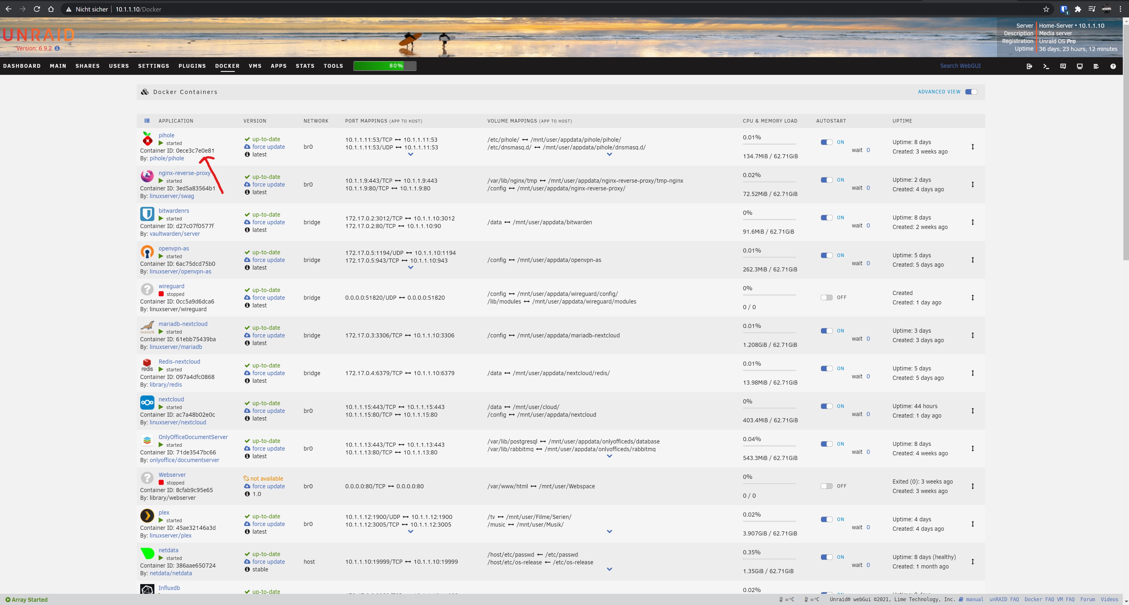

This is how it should look like: (Container-ID below the container name and picture)
288479214_1-InkedScreenshot2021-05-18155301_LI.thumb.jpg.1ba5a91947c7939a5cfa2bd2886308b1.jpg

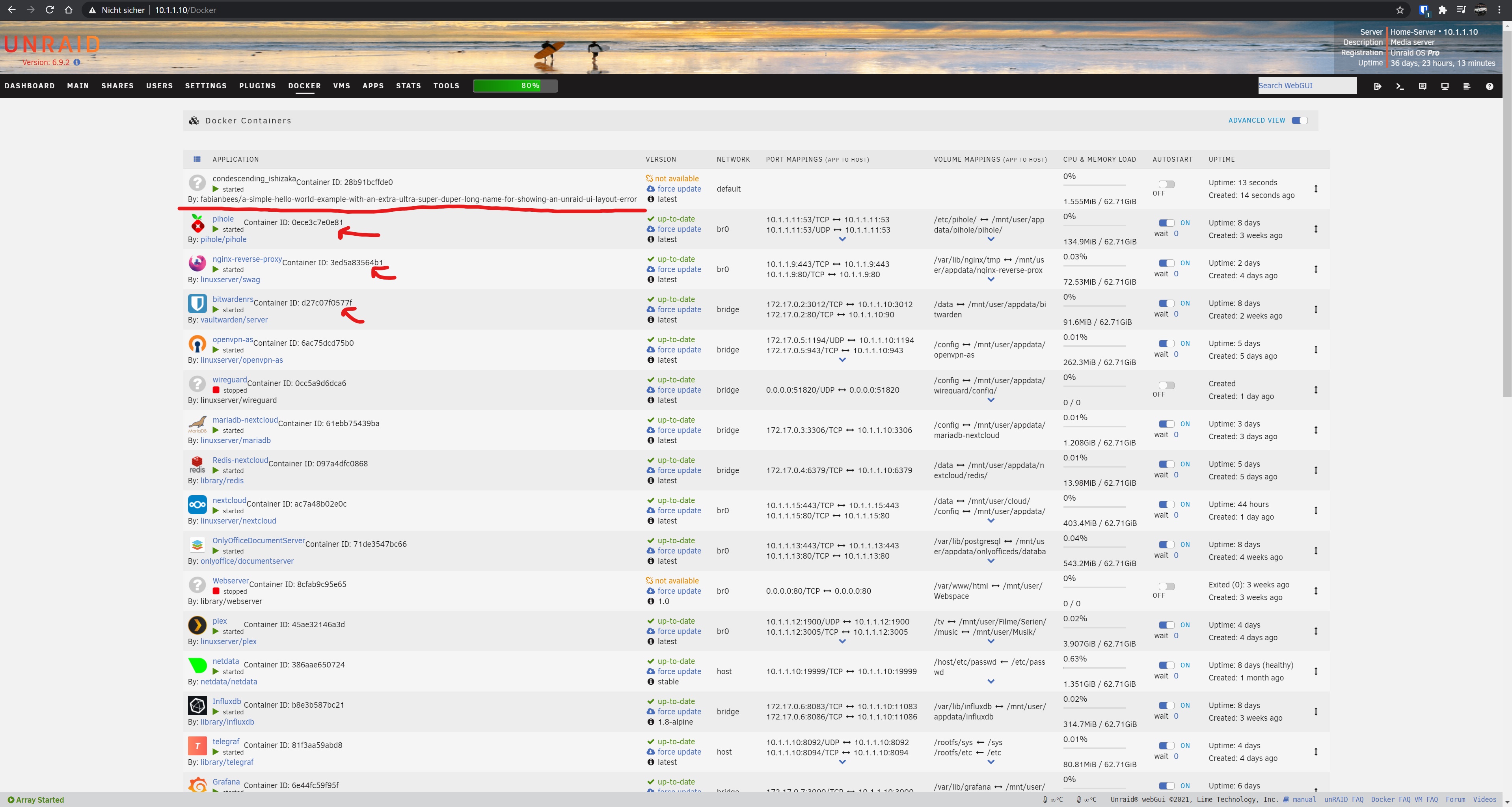

When a container with a very long image name is present it looks as follows: (Container-ID on the right hand side of the container name and picture)
1551929024_2-InkedScreenshot2021-05-18155416_LI.thumb.jpg.1c19cb6caf765c120b6f05c517bc16ac.jpg

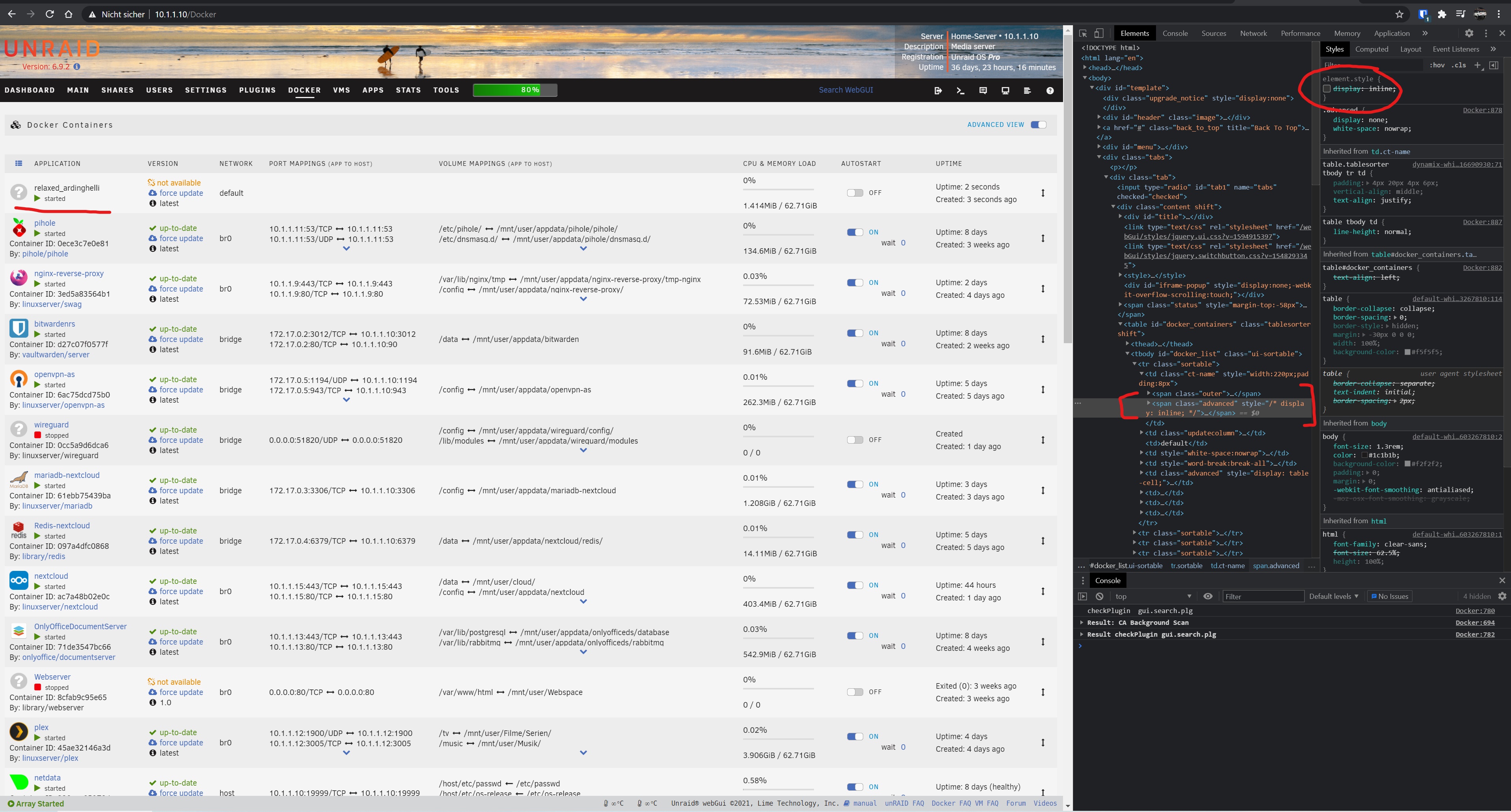

A simple fix could be to remove the display: inline; CSS from the class="advanced". This can be replicated with the Dev-Tools in the browser.
Then all is displayed normally but the long image name isn't visible any more (but thats a better solution than the current behavior).
Best solution would be to concat a long image name after a specifed width and show three dots at the end (e.g. long-name...).
120621929_4-InkedScreenshot2021-05-18155625_LI.thumb.jpg.480ab504cb3bfe168d667a8439cc261f.jpg
