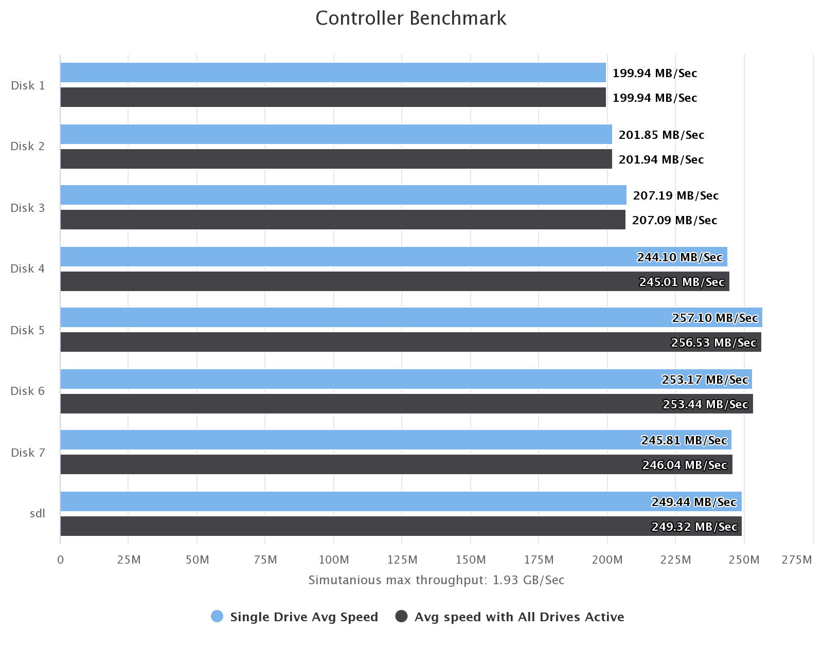

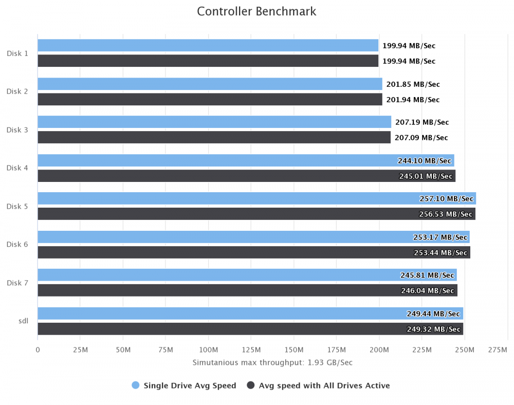

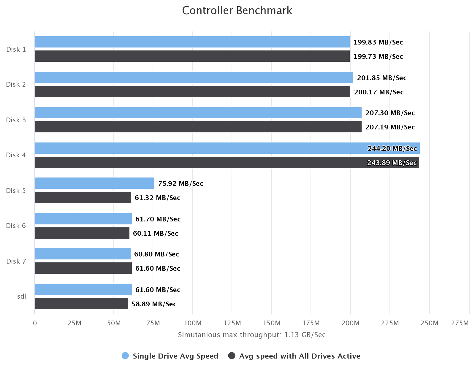

Drive benchmarks:
The benchmarks are also weird in that I got the second results by simplying spinning down and spinning up all the drives prior to just blindly benchmarking all my drives.
Testing this condition with the parity check also produces the same result - starting the parity check while the drives are spun down results in a prity check that runs at 777MB/s max, whereas spinning up all the drives first allows them hit the max speed of about 200MB/s
Also it seems only my Toshiba N300 drives are affected, and none of my Seagate Archive drives or drives on the onboard SATA controller seems to be affected (or I haven't noticed)
