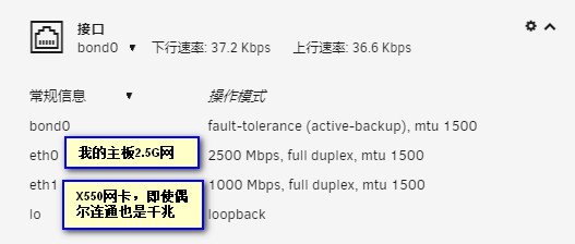

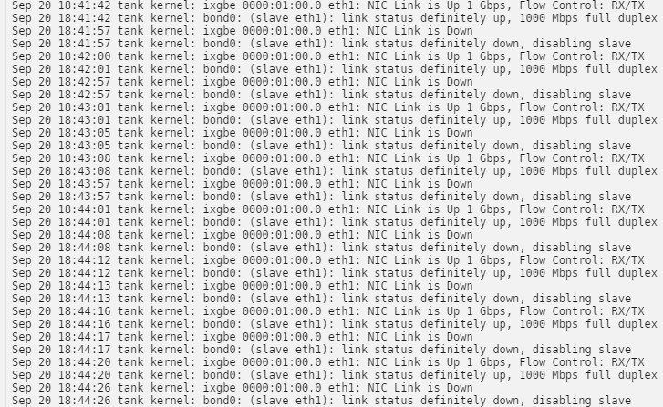

3. Problem: When I connect the network cable to the 2.5G switch, I cannot get the ip (but when connected to the gigabit switch, everything is normal. The Z490 motherboard comes with a 2.5G network card and everything is normal, or it is directly plugged into the native Windows system and everything is normal) , Check the log records and find that the network card is disconnected intermittently, which makes it unable to be connected (and even if it is connected occasionally, the network speed is only Gigabit!)
The unraid dashboard shows that the network speed is only Gigabit even if it is connected occasionally.

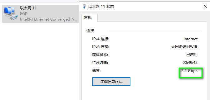

The network card that is directly connected to the virtual machine through sr-iov is also disconnected for a while, while the other network port that is directly connected to the virtual machine is completely normal, with a full 2.5G speed (the following picture shows the connection status of the physical through-through network card )
