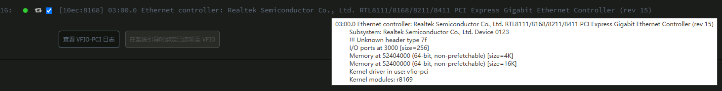

After a while of system startup, the 8111 graphics card displays "Unknown header type 7f"  and The error message when creating a virtual machine changes to ‘internal error: Unknown PCI header type '127' for device '0000:03:00.0'
