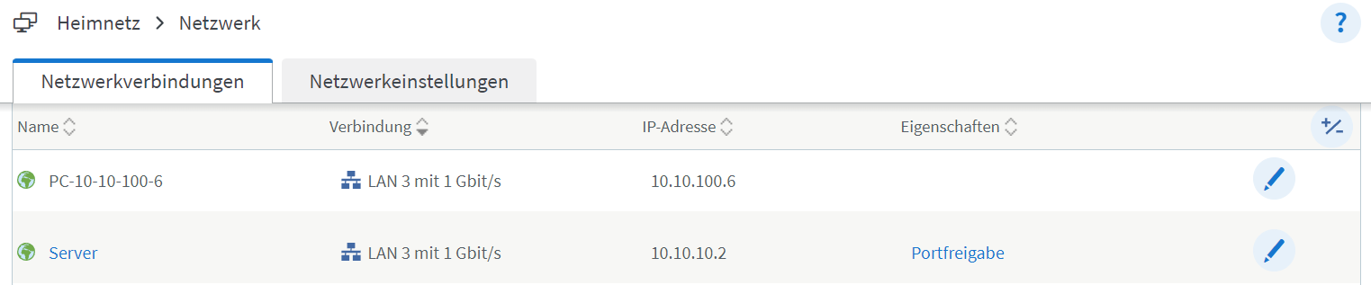

Everything seems to work just fine (and i almost deleted this thread i had written)... until something happenend... I don't know what causes this exactly but in my fritzbox, messes up the Ips of my server and it's docker containers... This is especially weird since i have set the ip of the server to static and also have checked the box to always assign the same ip on the fritzbox.
In the Overview of the fritzbox it shows up correctly:

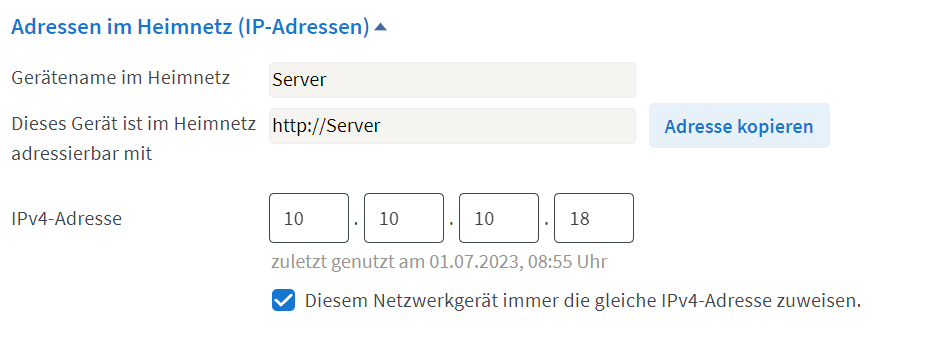

When I click on edit it shows a differen IP
as for example seen here:
This would be the tvheadend container... Sometimes (i don't know how this works) it shows up as the adguard container
The problem is that the port forwarding is then switched to this ip....

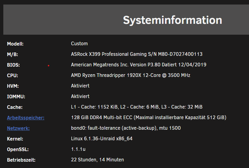

The thing is: I have a mainboard with 3(!) Network ports... of which 2 are not connected as I had trouble getting everything to work in the past. Here are my specs:
and of course a diagnostics zip is included here as well as syslog.
