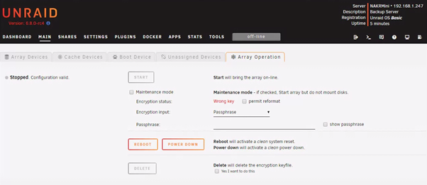

    Upgraded my test box to 6.8.0 stable this morning and am now unable to decrypt the array (using the same passphrase as I've used for the last year!).
    I experienced exactly the same issue with rc4 (see here and screenshot). If I roll back to 6.7.X - everything goes back to being fully functional.
