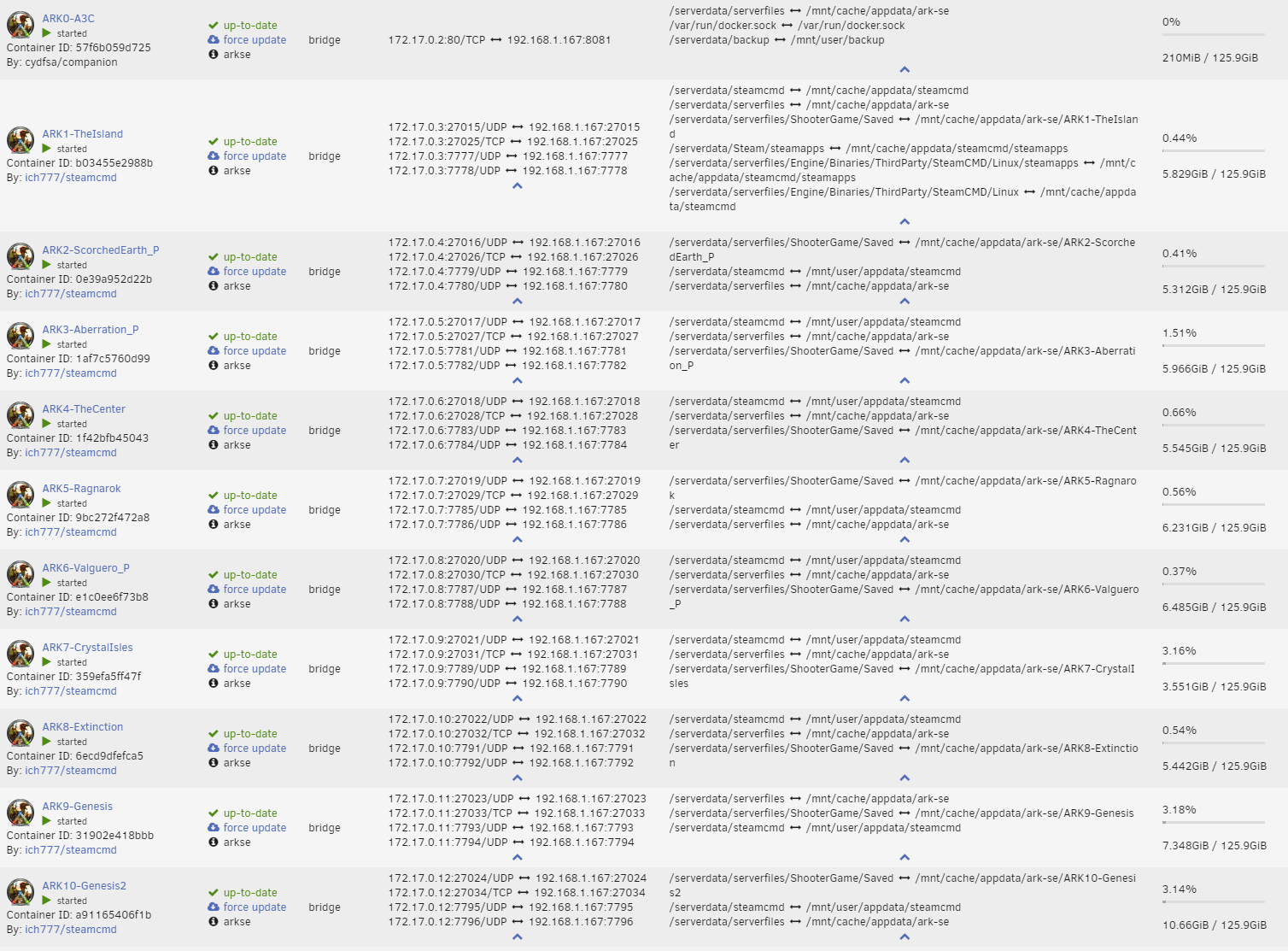

  8. @DinoBrain So about the -automodmanager ... it is effectively the shootergame binary making an external call to start a second copy of SteamCMD, and it expects it to be in a vary specific place. that's what those "extra" mappings are for. if you have put your copy of SteamCMD in some other place then the ich777 default /mnt/cache/appdata/steamcmd you will need to change the mappings so that shootergame can find it exactly where it expects it to be.
  9. @DinoBrain I haven't done much with the ARK cluster since I put it up, but here is a snap of my docker page. I don't think the XMLs have changed since we spun this up.
  10. @PPurEEviLL This sounds to me like a directory permissions issue. the cluster function is nothing more than a shared directory. To test I would log into the console of one of the containers on Server2, navigate to the cluster directory and try to touch a new file.

  15. @deaerator wouldn’t be to hard to do but I will not be able to get to it until next week. If you want just a dynamic config you can run a “simple-http” server container in place of a3c.
