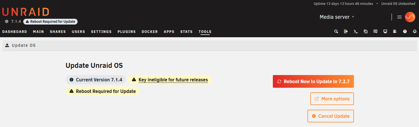

  1. Hi all, I've had the surprise this morning to have an update proposed on the unraid GUI of my server. Not having an active licence for a good time now, I thought this could have been related to security fixes and went on to download it and prepare USB key through the automated GUI to appy it. Yet before reboot, I've had a warning about active licence and wouldn't want to brick the installation. If this update proposal a bug ? I would prefer to manually cancel and rollback the update while it's still running, rather and have a manuel intervention onthe USB key itself. Thanks,
