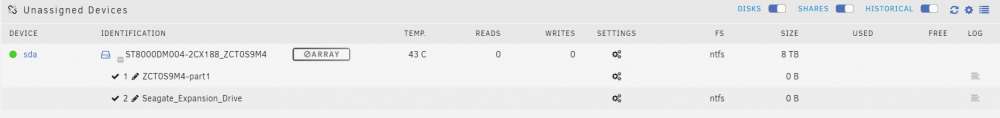

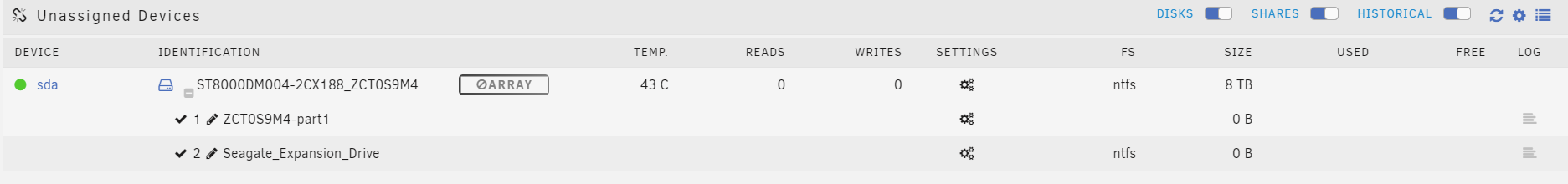

  3. I'm at a loss on this, my external Seagate drive that I use for backup will no longer show the option to have it mounted. It worked fine about a month ago. Now all it shows is a "no" symbol (circle w/line through it) followed by Array. Something funny is that Seagate_Expansion_Drive partition is the primary partition, it should be showing up as essentially 8TB in size, but that's no the case right now. I've tried: *Another USB drive which works fine, and allows me to mount it as an unassigned disk. *Connecting the Seagate drive to a Windows machine and it works fine *Different USB ports on the Unraid machine I haven't tried a reboot yet, but figured since other drives appear to be working, I don't think a reboot is the solution. Plus I like seeing that big uptime number Anything else I can try?
