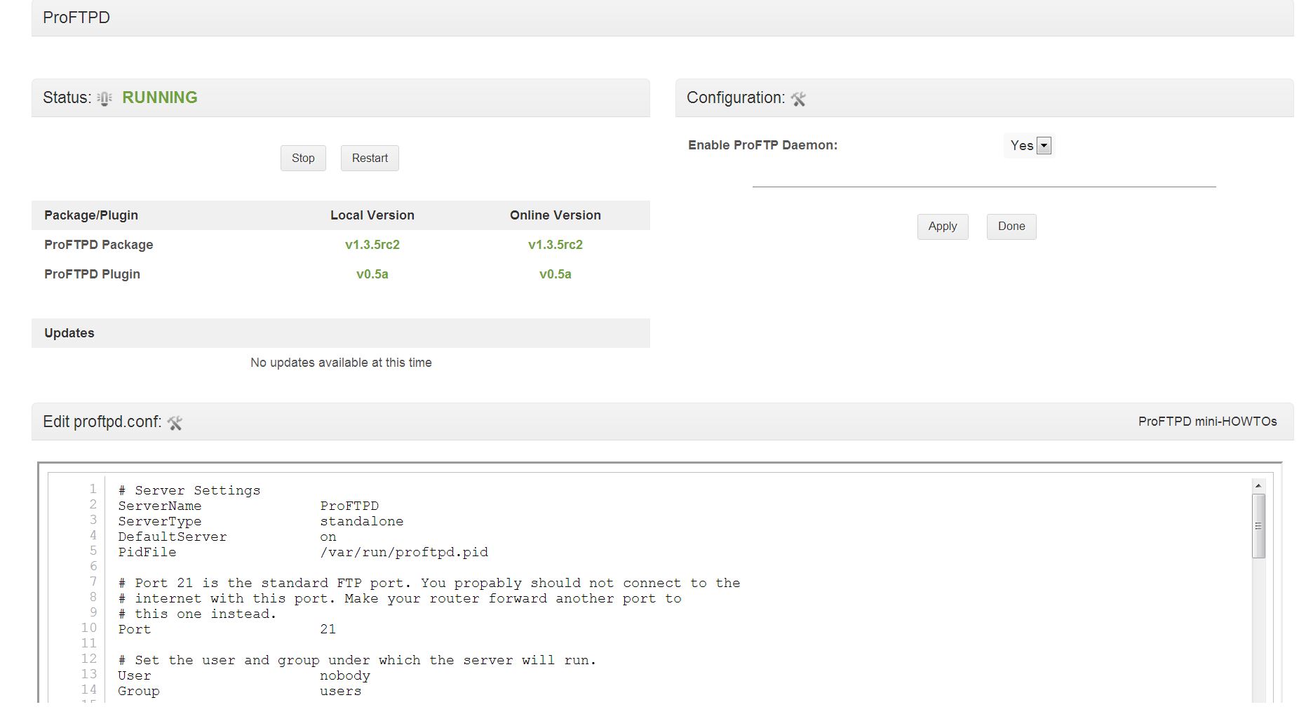

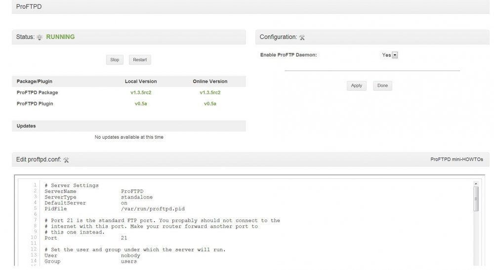

  5. i tried rebooting the server but didn't help. i also tried stopping and starting the proftp, didn't help neither.

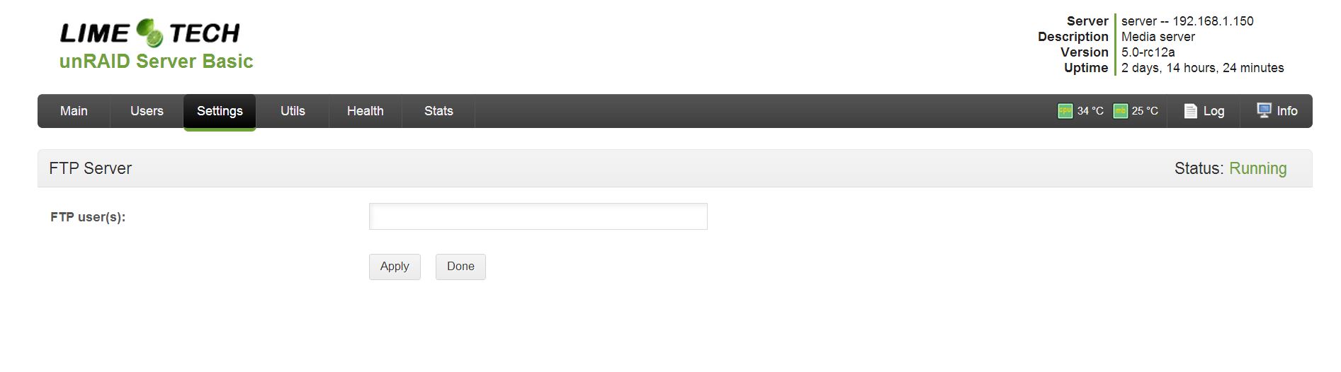

  6. Are you sure it is the internal FTP that is running? yes Is the proftpd plugin icon now present in Settings? yes Do you get the config editor window on the plugins settings page? yes May 24 01:59:53 server logger: ----------------------------------------------------------- May 24 01:59:53 server logger: SimpleFeatures 'web.server' has been installed. May 24 01:59:53 server logger: This plugin requires SimpleFeatures core webGUI to operate May 24 01:59:53 server logger: Copyright 2012, Bergware International & Andrew Hamer-Adams May 24 01:59:53 server logger: Version: 1.0.11 May 24 01:59:53 server logger: ----------------------------------------------------------- May 24 01:59:53 server logger: May 24 01:59:53 server logger: success May 24 01:59:53 server logger: file /var/log/plugins/simpleFeatures.web.server: successfully wrote INLINE file contents May 24 01:59:53 server logger: plugin successfully installed May 24 01:59:53 server logger: installing plugin: proftpd May 24 01:59:53 server logger: file /tmp/plugin-prepare: successfully wrote INLINE file contents May 24 01:59:53 server logger: /bin/bash /tmp/plugin-prepare ... May 24 01:59:53 server logger: May 24 01:59:53 server logger: ************************************************************* May 24 01:59:53 server logger: * ProFTPD plugin installation started... May 24 01:59:53 server logger: ************************************************************* May 24 01:59:53 server logger: May 24 01:59:53 server logger: success May 24 01:59:53 server logger: file /tmp/plugin-cleanup: successfully wrote INLINE file contents May 24 01:59:53 server logger: /bin/bash /tmp/plugin-cleanup ... success May 24 01:59:53 server logger: file /boot/config/plugins/proftpd/README: already exists May 24 01:59:56 server logger: file /boot/config/plugins/proftpd/device_status.png: downloading from -q --no-check-certificate https://github.com/SlrG/unRAIDplugins/raw/master/proftpd/device_status.png ... success May 24 01:59:56 server logger: file /usr/local/emhttp/plugins/images/device_status.png: successfully copied LOCAL file May 24 01:59:58 server logger: file /boot/config/plugins/proftpd/new_config.png: downloading from -q --no-check-certificate https://github.com/SlrG/unRAIDplugins/raw/master/proftpd/new_config.png ... success May 24 01:59:58 server logger: file /usr/local/emhttp/plugins/images/new_config.png: successfully copied LOCAL file May 24 01:59:58 server logger: file /boot/config/plugins/proftpd/proftpd.conf: successfully wrote INLINE file contents May 24 02:00:00 server logger: file /boot/config/plugins/proftpd/proftpd.png: downloading from -q --no-check-certificate https://github.com/SlrG/unRAIDplugins/raw/master/proftpd/proftpd.png ... success May 24 02:00:00 server logger: file /usr/local/emhttp/plugins/proftpd/proftpd.png: successfully copied LOCAL file May 24 02:00:00 server logger: file /usr/local/emhttp/plugins/proftpd/proftpd.page: successfully wrote INLINE file contents May 24 02:00:00 server logger: file /boot/config/plugins/proftpd/proftpd.cfg: successfully wrote INLINE file contents May 24 02:00:00 server logger: file /usr/local/emhttp/plugins/proftpd/proftpd.php: successfully wrote INLINE file contents May 24 02:00:03 server logger: file /boot/config/plugins/proftpd/proftpdce.zip: downloading from -q --no-check-certificate https://github.com/SlrG/unRAIDplugins/raw/master/proftpd/proftpdce.zip ... success May 24 02:00:03 server logger: file /etc/rc.d/rc.proftpd: successfully wrote INLINE file contents May 24 02:00:03 server logger: successfully changed file mode May 24 02:00:03 server logger: file /usr/local/emhttp/plugins/proftpd/event/disks_mounted: successfully wrote INLINE file contents May 24 02:00:03 server logger: successfully changed file mode May 24 02:00:03 server logger: file /usr/local/emhttp/plugins/proftpd/event/unmounting_disks: successfully wrote INLINE file contents May 24 02:00:03 server logger: successfully changed file mode May 24 02:00:03 server logger: file /var/log/plugins/proftpd: successfully wrote INLINE file contents May 24 02:00:03 server logger: file /tmp/proftpd-install: successfully wrote INLINE file contents May 24 02:00:03 server logger: /bin/bash /tmp/proftpd-install ... May 24 02:00:03 server logger: Looking for locally saved version of proftpdce... May 24 02:00:03 server logger: Found up to date local versions of proftpdce... May 24 02:00:06 server logger: Looking for locally saved version of proftpd packages... May 24 02:00:06 server logger: Local package does not exist, downloading proftpd-1.3.5rc2.tgz to /tmp May 24 02:00:13 server logger: Local package does not exist, downloading proftpd-1.3.5rc2-sql.tgz to /tmp May 24 02:00:21 server logger: Deleting old builds from /boot/config/plugins/proftpd... May 24 02:00:21 server logger: Moving downloaded versions from /tmp/ to /boot/config/plugins/proftpd/... May 24 02:00:21 server logger: No SQL found. Installing proftpd without SQL support... May 24 02:00:21 server logger: May 24 02:00:21 server logger: +============================================================================== May 24 02:00:21 server logger: | Installing new package /boot/config/plugins/proftpd/proftpd-1.3.5rc2.tgz May 24 02:00:21 server logger: +============================================================================== May 24 02:00:21 server logger: May 24 02:00:21 server logger: Verifying package proftpd-1.3.5rc2.tgz. May 24 02:00:21 server logger: Installing package proftpd-1.3.5rc2.tgz: May 24 02:00:21 server logger: PACKAGE DESCRIPTION: May 24 02:00:21 server logger: Executing install script for proftpd-1.3.5rc2.tgz. May 24 02:00:21 server logger: Package proftpd-1.3.5rc2.tgz installed. May 24 02:00:21 server logger: May 24 02:00:21 server logger: May 24 02:00:21 server logger: Disable builtin FTP-Server... May 24 02:00:21 server logger: Restart inetd to apply change... May 24 02:00:22 server logger: Starting Internet super-server daemon: /usr/sbin/inetd May 24 02:00:22 server logger: Remove example config file... May 24 02:00:22 server logger: Symlink new config file... May 24 02:00:22 server logger: May 24 02:00:22 server logger: ************************************************************* May 24 02:00:22 server logger: * ProFTPD plugin has been installed. May 24 02:00:22 server logger: * Copyright 2013, SlrG May 24 02:00:22 server logger: * Version: 0.5a May 24 02:00:22 server logger: ************************************************************* May 24 02:00:22 server logger: May 24 02:00:22 server logger: success May 24 02:00:22 server logger: plugin successfully installed May 24 02:00:22 server emhttp: unRAID System Management Utility version 5.0-rc12a
