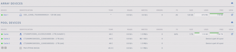

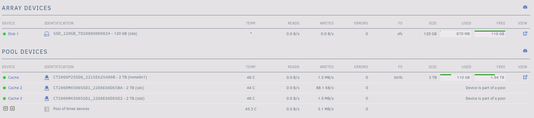

  7. Hi all, I recently wanted to replaced my drives from 2x 2TB HDDs (In Array) and 2x 128GB SSDs (In Pool) to 3x 2TB SSDs (In Array). However, upon reading some other forums, it seems that having SSDs in an array is not supported due to the TRIM function. I have hence created a pool with the 3 disks and used an old SSD as a single drive in the array just so the array can start (maybe this should be fixed in the future to allow the array to start with just pool disks). The issue I am seeing is that the pool is correctly marking the pool as 3TB in size (6TB / 2). I have 110GB used and the free space is being marked as 1.94TB. Where's the other 1 TB? Thanks.
