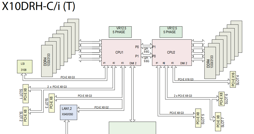

  5. Update: I ran the following to erase both bios and firmware. sas2flsh -c 1 -o -e 6 Shutdown and restarted. Then ran P20 firmware and bios update. sas2flsh -c 1 -o -f 9201-16e.bin -b mptsas2.rom No errors Went back into the MB bios and changed bifurcation. According to the SM X10DRH-iT manual, PCI-E slot 6 & 7 are on CPU2 and on the same IOU so I set the CPU2a and CPU2c bifurcation to 8X8. Rebooted and got an 8TB red to populate. I plugged another 8TB red that I didn't remove the 3.3v pin and a 14TB white with 3.3v pin removed but neither of them populated. I think there is still something with bifurcation or possibly something else in the MB bios that is preventing the other drives from populating. I'll wait for formatting to finish and then see about my next steps. All 3 drives on the 9211-8i in slot 6 populate. Only 1 drive on the 9201-16e in slot 7 populate.
  6. PCI bifurcation on the MB? I'll have to do some research to understand which BIOS bifurcation settings correspond to the specific PCIe slots on the board. It's an x10DRH-iT board. Working card is in slot 6. (x8) CPU2 NVidia card is inserted in slot 4 (x16) CPU2 Non-working card is in slot 2. (x8) CPU1 Here's the link to the MB on SuperMicro. https://www.supermicro.com/manuals/motherboard/C600/MNL-1628.pdf Should I run both cards on CPU2 along with the NVidia card?
