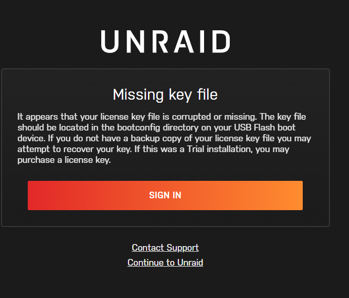

  2. Now i have the same Problem again... something must be defective. Please help! In the Root Console Everything is there: But webui if not accesable. Can´t pull a new diagnostics file.
  3. It´s working atm. What i did. i started the array in "Maintenance" Mode then stopped it. Then started it normally. Now its not "buggy". i´ve added the new diagnostics file. best regards schnub bronas-diagnostics-20210706-1135.zip

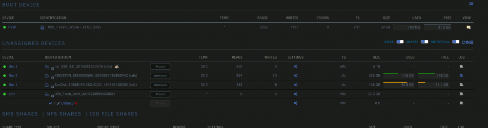

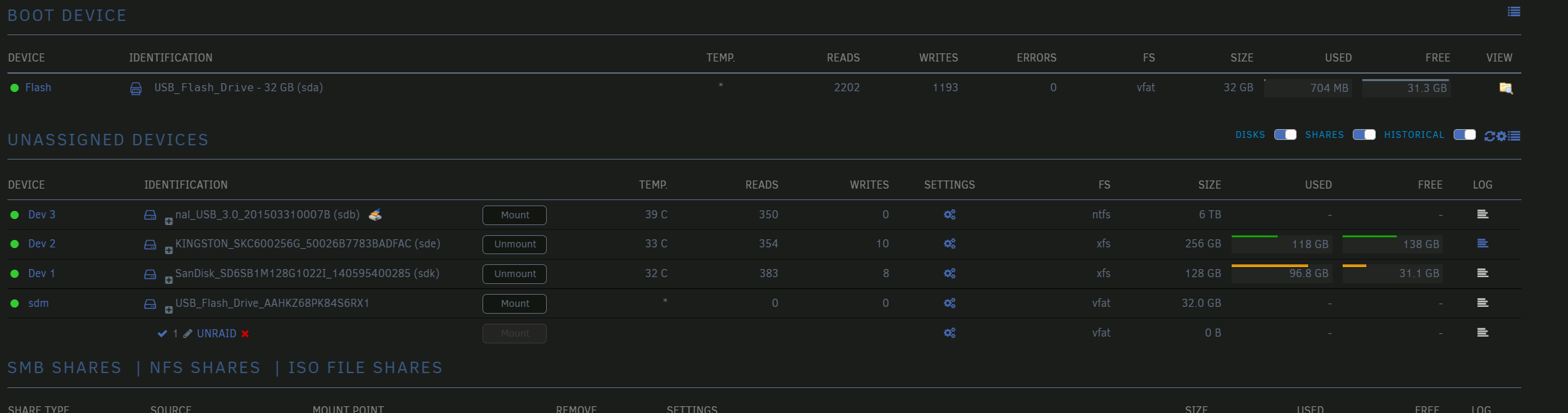

  4. I´ve sorted that issue out. It was a faulty cache drive. This can now be closed. Thanks !

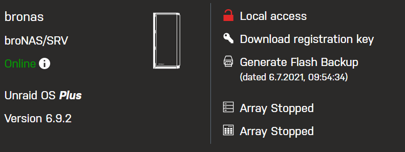

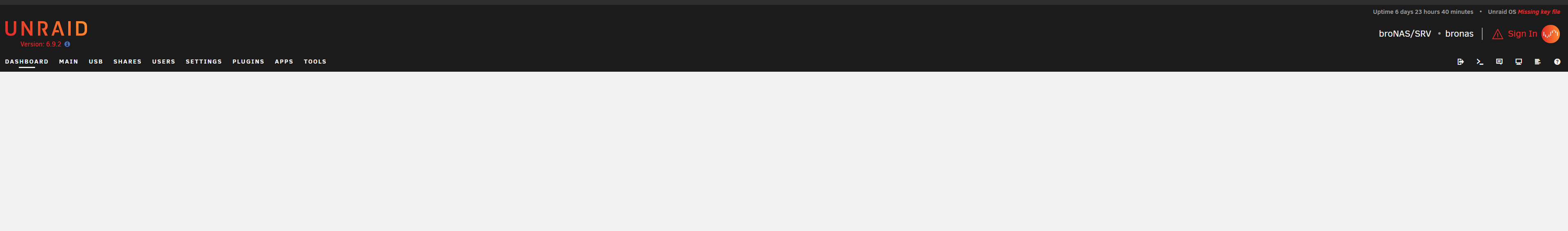

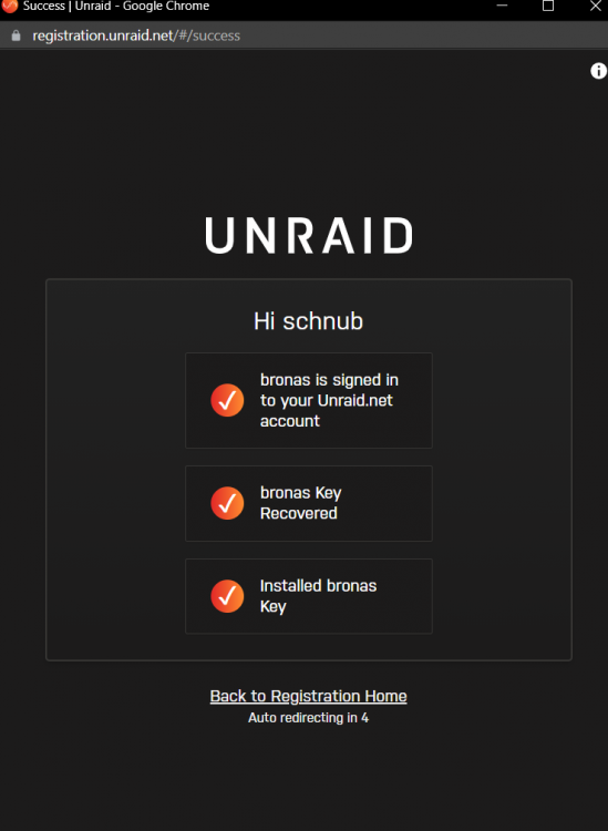

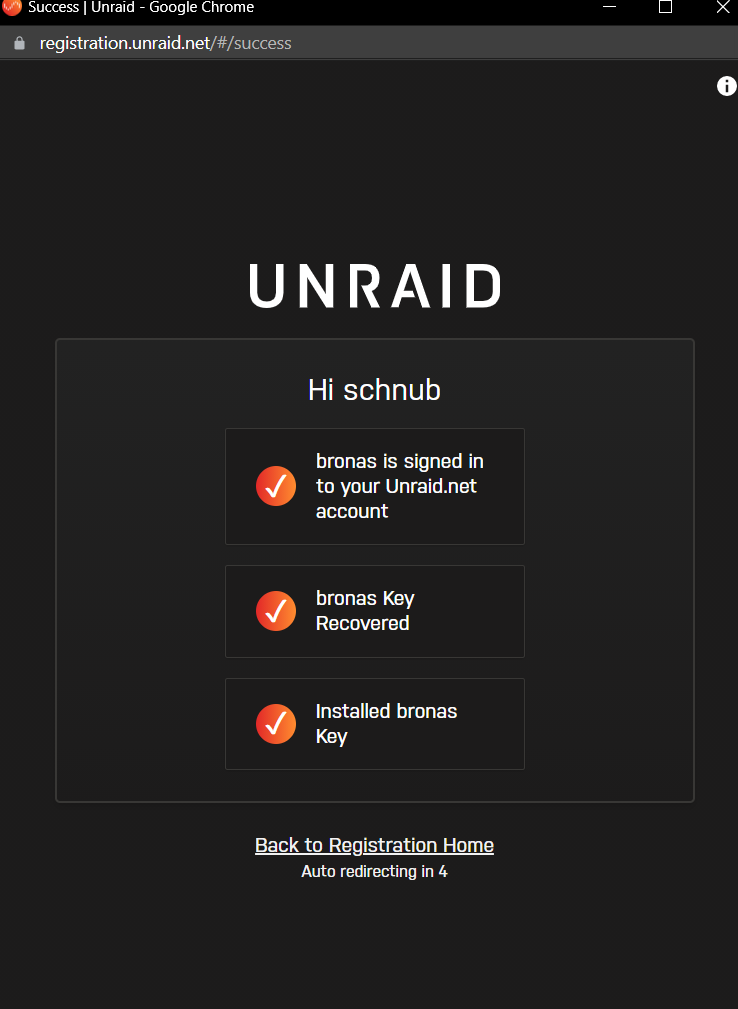

  5. EDIT: It looks like the Unraid USB Stick is getting mounted! I saw warning in the upper right corner with NO FLASH in red. Then the missing key showed up. I didn´t change anything. How to prevent the UNRAID OS Stick from getting mounted in unassigned devices? Dear Community, after i tried to log me in to my unraid system this morning i was greeted by a different style of dashboard and a blank white screen with the warning "Missing Key file". Everything was running (VM,DOCKER,etc.) but no way to show it in the browser. i tried different browser to double check. nothing. Then i tried to recover the licence which failed. or it says it has done the magic and the the same screen again. First this: Then this is shown: What i observerd after a "powerdown -r" in via the shell, that the server starts fine and no key error shows until i start the array. if i then change to e.g. the docker section the white screen with the misssing key is shown. but i was stay with one tab on the Main Tab, then i saw something strange. The 32GB Stick from unraid was shown at "unnasigned drives". Maybe the stick is faulty? or something is messed up? I got the unraid beta backup plugin running. What would be the best path to start with a new usb stick? i also got a backup from 4 days ago which should be fine. (no idea how to download it and if it must be the same stick or could be a new one) sorry im from Germany maybe my sentences doesn´t make any sense best regards schnub PS: The diagnostics file is after the reboot. Because i cant get the diagnostics file after the array is started. bronas-diagnostics-20210706-0952.zip
