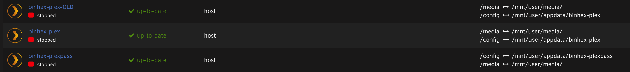

  1. the error started three builds ago ... when it was upgraded to 1.32.1 anything before this works fine
  2. interesting ... i just did that and now recieving the same error with the plexpass container. so it must not be an issue with the container, it must be an issue with the config files in /mnt/user/appdata/binhex-plex ... i wonder if there was an upgrade to the database which was missed in a prior version or something ... i really dont know. I think the best thing to do is just create a new appdata dir and rebuild my libraries
  3. Plexpass latest works fine, i also just tried to re-install the docker app and got the same results. i guess i will use the plexpass version going forward ... question ... can i point the /config property at my old /mnt/user/appdata/binhex-plex directory so i dont have to copy all my metadata files to/mnt/user/appdata/binhex-plexpass??
  4. i appreciate that and i fully understand -- let me try to deploy the plexpass latest version side by side to see if makes a difference
  5. I just posted what appears to be the same issue with the "latest" tag docker image. Sorry for reposting, i didnt see this post prior to submitting mine. I've been able to workaround it by doing the same as you, using a specific version tag and not grabbing the latest version of the docker image. Following this thread now as well as mine ... Best regards, -Tiger
