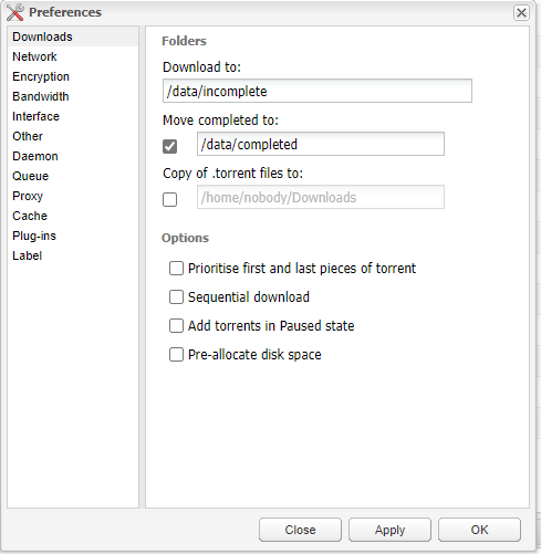

  5. Hi, I tried and it created the file succesfully. No error. Any other idea ? concerning my free space Deluge indicate me more than 4TB free so I don't think it is causing the issue.

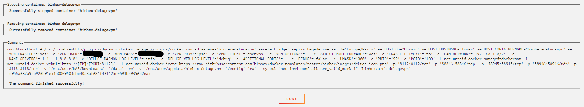

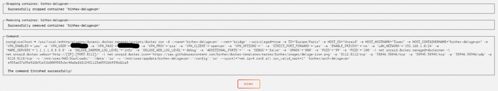

  6. Here you go for the docker run and deluge downloads settings.
  7. Hi everybody, long time user of your excelent templates Binhex. It works like a charm and I'm really happy with it. However, for 4 days I was able to access the webui, add torrents (manually or by an ARR app), view my VPN (pia) adress but nothing downloads, eveything is stuck at 0%... I can see some kB/s traffic at the moment I add a torrent and then nothing. I can't see anything in the container logs and for a test, I installed deluge and PIA VPN app on a windows machine to try one of my torrent that is stuck in the container and it works, so neither my vpn provider or torrent provider is blocking me. Where can I have a look to be able to troubleshoot this weird issue ?
