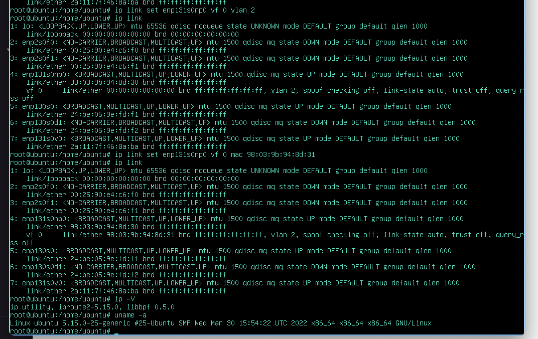

  2. So it seems like this is a problem with unraid. I booted from an ubuntu flash drive and it works fine - I will file a bug. I am not really sure where the problem is but it seems like the kernel.
