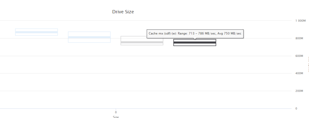

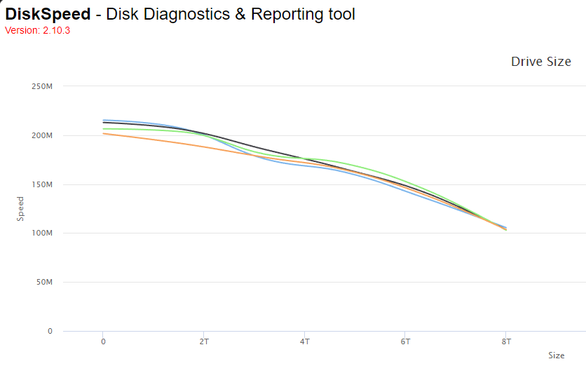

  1. Diskspeed: HDDs: SSDs:
  2. I'll re-run diskspeed, but it shouldnt. I have 2 SSDs for cache

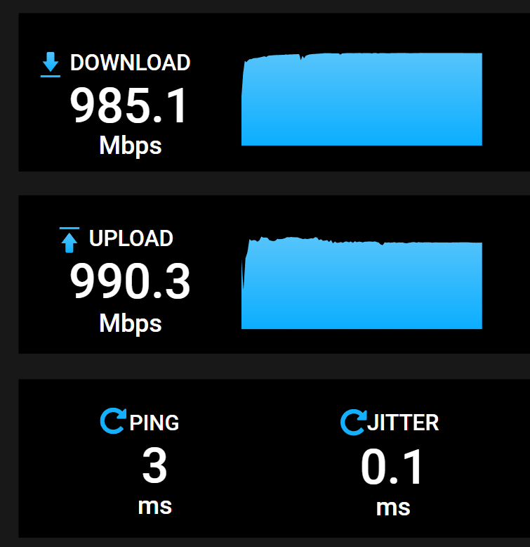

  6. No other device on the same network has any issues. What should I look at on my router? Here is docker run --rm --net=host tianon/speedtest --accept-license run directly on my router:

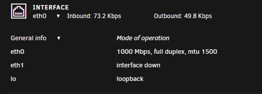

  7. Updated tests: from docker network inspect: Settings for eth0: Supported ports: [ TP ] Supported link modes: 10baseT/Half 10baseT/Full 100baseT/Half 100baseT/Full 1000baseT/Full Supported pause frame use: Symmetric Supports auto-negotiation: Yes Supported FEC modes: Not reported Advertised link modes: 10baseT/Half 10baseT/Full 100baseT/Half 100baseT/Full 1000baseT/Full Advertised pause frame use: No Advertised auto-negotiation: Yes Advertised FEC modes: Not reported Speed: 1000Mb/s Duplex: Full Auto-negotiation: on Port: Twisted Pair PHYAD: 1 Transceiver: internal MDI-X: on (auto) Supports Wake-on: d Wake-on: d Current message level: 0x00000007 (7) drv probe link Link detected: yes iperf3 shows gig speeds and file transfers are fast as well relevant parts of docker network inspect: "Name": "bridge", "Id": "###", "Created": "2023-02-09T19:36:20.054881309-05:00", "Scope": "local", "Driver": "bridge", "EnableIPv6": false, "IPAM": { "Driver": "default", "Options": null, "Config": [ { "Subnet": "172.17.0.0/16", "Gateway": "172.17.0.1" } ] }, "Internal": false, "Attachable": false, "Ingress": false, "ConfigFrom": { "Network": "" }, "ConfigOnly": false, "Options": { "com.docker.network.bridge.default_bridge": "true", "com.docker.network.bridge.enable_icc": "true", "com.docker.network.bridge.enable_ip_masquerade": "true", "com.docker.network.bridge.host_binding_ipv4": "0.0.0.0", "com.docker.network.bridge.name": "docker0", "com.docker.network.driver.mtu": "1500" Host speedtest docker run --rm --net=host tianon/speedtest --accept-license: 'Bridge' speedtest docker run --rm --net=bridge tianon/speedtest --accept-license:

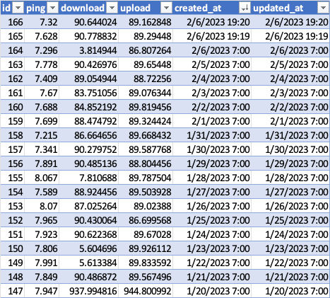

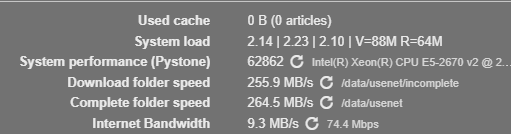

  11. Nakor started following Slow Docker Network?
