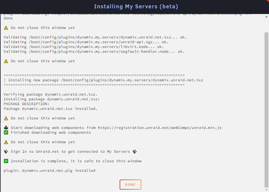

  10. At this point, I've probably reinstalled about 4-5 times, I always let it complete
  11. Also having same issue creating diagnostics. running unraid-api reports command not found (Output is anonymized, use '-vv' to see full details) Unraid OS 6.10.3 with My Servers plugin version 2022.07.26.1609 ✅ Signed in to Unraid.net as CorvinusLucian Use SSL is yes ✅ Rebind protection is disabled for myunraid.net Local Access url: https://[redacted]:44300 ✅ 10-0-2-254.hash.myunraid.net resolves to 10.0.2.254 Request: { "keyfile": "[redacted]", "plgversion": "2022.07.26.1609", "internalhostname": "[redacted]", "internalport": "44300", "internalprotocol": "https", "remoteaccess": "no", "servercomment": "", "servername": "[redacted]", "internalip": "10.0.2.254" } Response (HTTP 200): [] success
  12. I've just updated the My Servers plugin (2022.07.26.1609) and now get the following error: "The My Servers plugin is out-of-date and will not connect to Unraid's cloud services. Please update the plugin." My Servers section of unraid.net shows my server as offline. I uninstalled and then reinstall the plugin, no joy. I have no 0 byte files, and my server DNS was already set to cloudflare & google backup My webgui is on a different port for NPM (44300) In the interim is possible to manually rollback to previous release?
