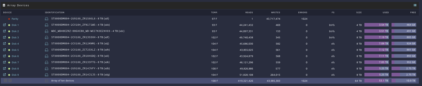

  1. Thank you for the help. Indeed it was just a case of bad luck and the new drive had errors. Swapped it with a replacement and it worked like a charm.
  2. Hello, I recently swapped my parity drive for a new one since the old was getting disabled and showed 2048 errors. However now that Im doing my first sync with my new drive I am getting the exact same thing but with 1024 errors. No other drive seems to be showing an error so I am confused on whats going on and how to remedy the issue. Any help would be appreciated! unraider-diagnostics-20231104-1956.zip unraider-smart-20231105-0223.zip
