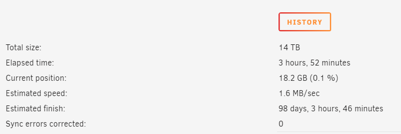

  3. Hi all, I tried transferring data from my cache drive to Disk 6 using Dynamix File Manager today but the transfer was horribly slow, and UNRAID eventually hung. I tried shutting UNRAID down via terminal but it would not shut down. I ended up pulling the plug, rebooting, and starting a parity rebuild. Parity rebuild, however, has been unacceptably slow: 1.6 MB/sec. 98 days to rebuild. I checked my logs and am getting "failed command: READ FPDMA QUEUED." I don't know what this means. Can anyone offer insight and help? ribeye-diagnostics-20230716-2116.zip
