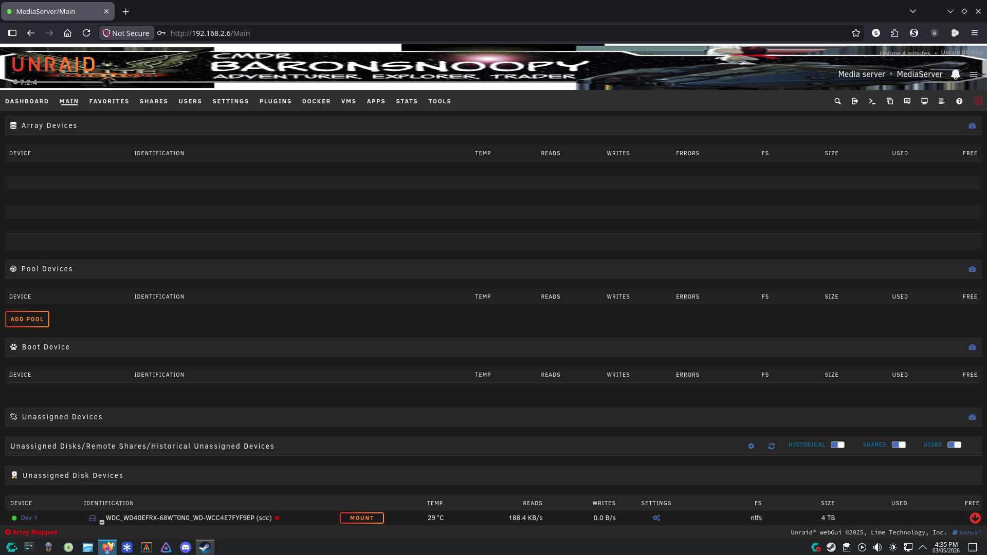

  1. Yes that is expected. Disk 4 was showing a pre-fail SMART warning and I was planning to replace it. It was in place the first time I started up and found the entire array gone. Thinking it may have failed and was holding down the SATA controller I shutdown and unplugged it but that didn't fix the problem. I then thought maybe the SATA controller failed so I plugged the replacement drive into the removable HDD cradle and it showed up meaning the SATA controller was working. That's when I came here for help. QH wow, changing browser worked, it's now showing all the drives. Wonder why the GUI suddenly stopped working properly in Firefox. Will have to look into that. Thanks for the help. P.S. It turned out that the issue was with my NoScript pluggin, for some reason it started blocking scripts on my local network. GUI is now working in Firefox. Thanks again for your time and help.

  3. Diagnostics doesn't seem to be working, I left it running for over 20mins. I tried the power cycling and even tried rebooting into Safe Mode. Still no drives showing. Cannot seem to be able to do much through the browser GUI. I'm not sure what else I can do. I can connect via SSH but have no idea what to do to fix this.
