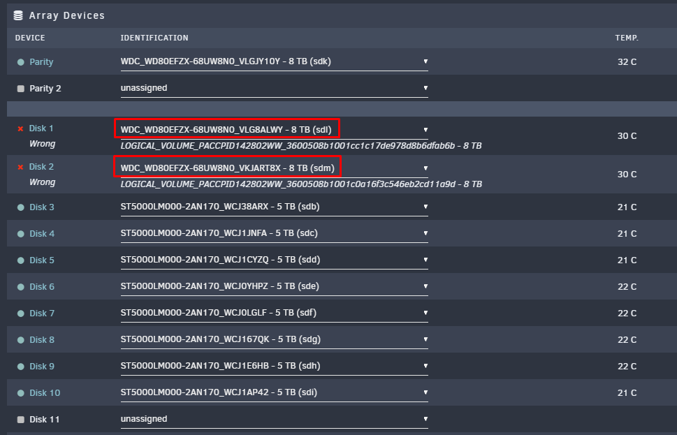

  1. Thanks for that info, not sure why the decided to loose its HBA config. It was always working with the SFF-8087 to 4-Port SATA cable. I do have a spare drive so I will add that and see if I can rebuild it drive by drive, if not I will need to use UD to copy the files over.

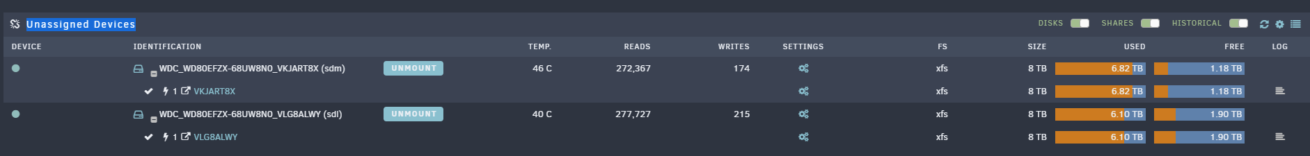

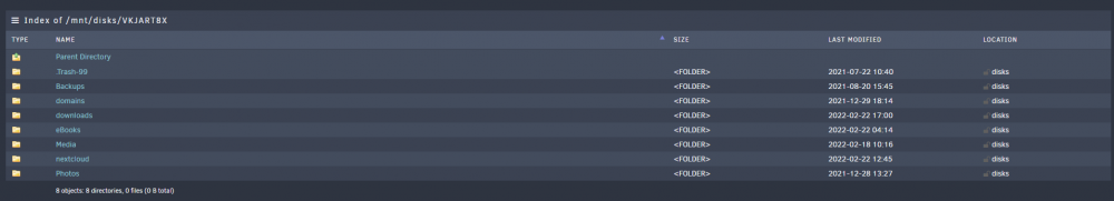

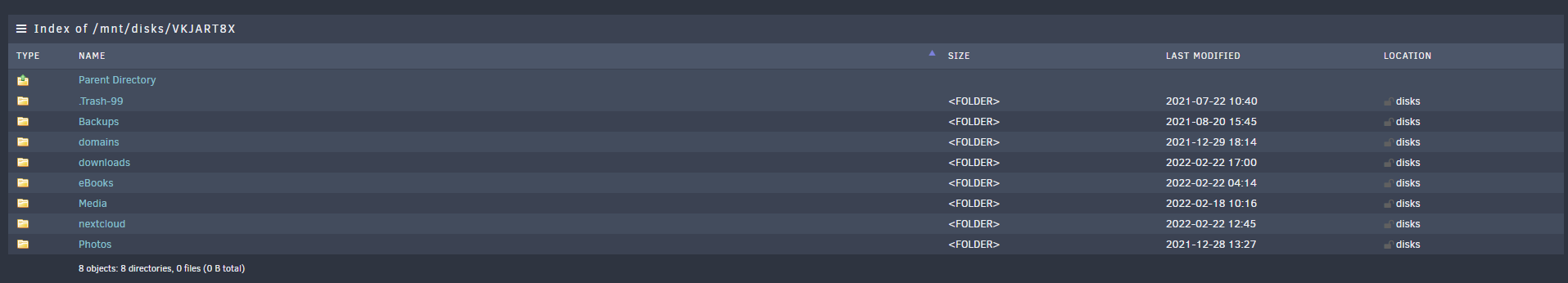

  2. Also, if I mount them using the unassigned plugin, I can see all my files.

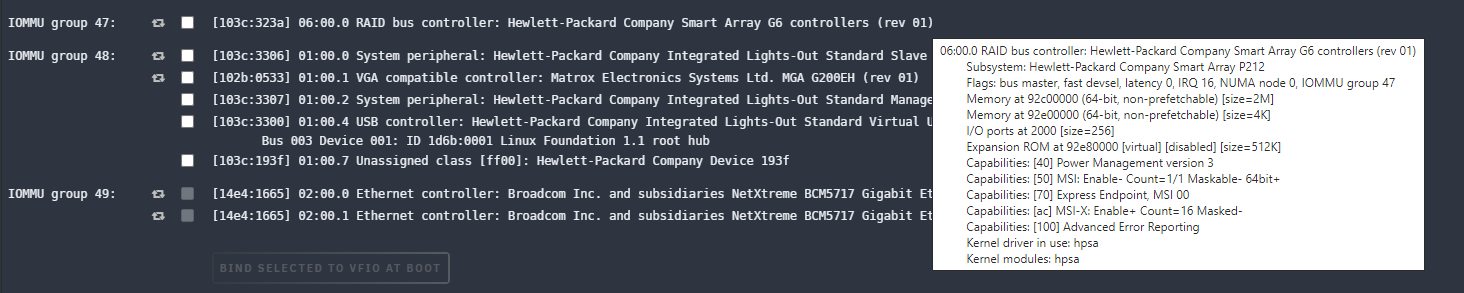

  3. Hi guys I've restarted my server this morning and my array refused to start. I then checked in the GUI and for some odd reason, my UNraid server is now refusing to see my drives, and wants to enable this logical volume. The card I use is a HP P212 with IT mode (HBA) mode enabled. Cable is a SFF-8087 to 4 port SATA Can anyone please advise how I go about fixing this?
