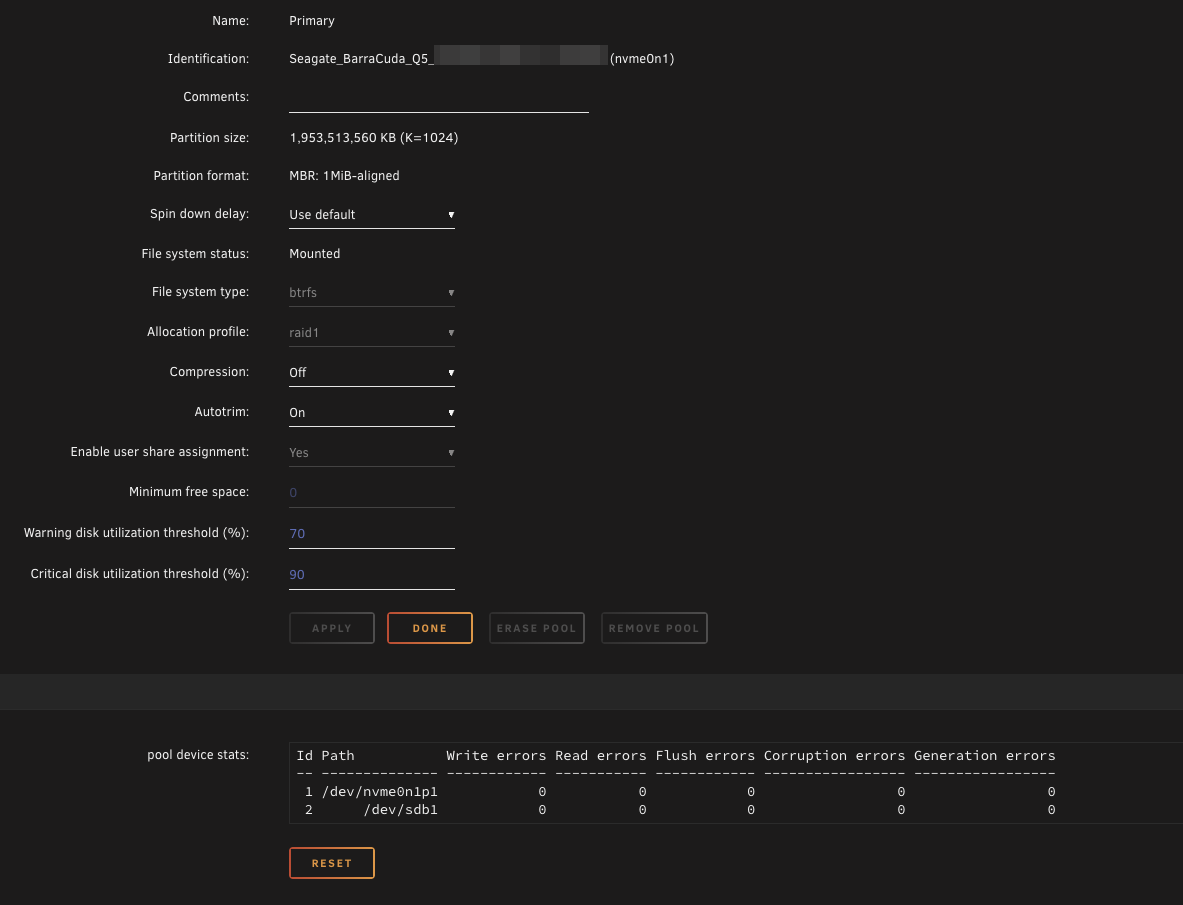

Moving data from a 2-drive BTRFS Pool to just one of the drives
Is it possible from within unraid to move data off one of a 2-drive BTRFS pool to the other? One is an NVME SSD, the other a 2.5" Drive. I pooled them together but my VMs are running slowly on the spinny disk, so want to move back to a single drive pool with the NVME SSD for the VM data disk.
