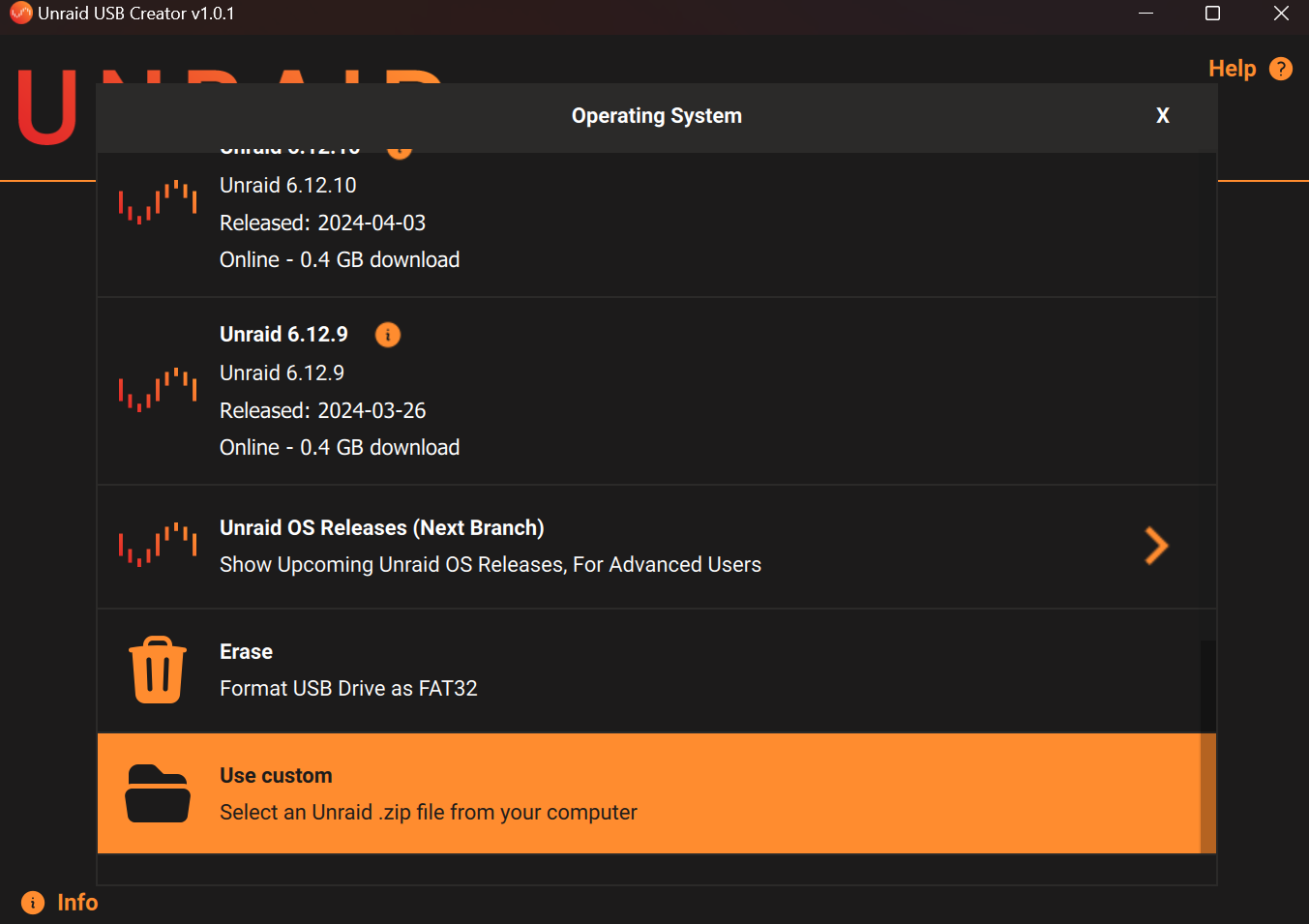

  4. The Unraid USB Creator doesn't allow me to select anything < 6.12.9 ☹️ I have an unresolved stability issue for >6.12.5 Can I not format the new flash drive with the backup zip I have and then activate with the new license?
  5. Thanks! I was on 6.12.5, so I'll setup the new flash drive with the same version. What about all of the data drives in the server? Will they be okay with this process? I'm nervous doing this given the amount of data, apps, VMs and history at risk. Now that I have my latest backup as a zip, is there a file in there that will help me confirm the exact version I was running?

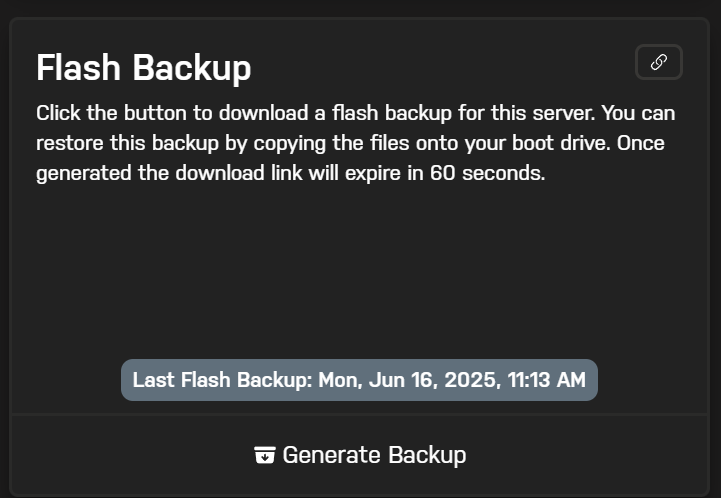

  6. My USB flash drive finally failed after 12 years. I had a Pro license key attached to it which was purchased for me by a friend, so it's not in my name and not attached to my account. Last year, I realised this is not completely compliant (sorry!), so I purchased a new Pro license key last year in anticipation of my flash drive eventually seeing its end. I now have my replacement flash drive in-hand and want to get the server running again, however, I would like to restore the backup onto this new flash drive, but use the new yet-to-be-activated license that I purchased last year. What do I do? Can I restore my flash to a new USB drive and use a different license key, or must I contact my friend to switch the GUID on the old license key? P.S. How do I download the latest flash backup from Unraid Connect? I can see the Last Flash Backup date but no button to download it. Only a button to generate a new backup. "Generate Backup" = download backup
