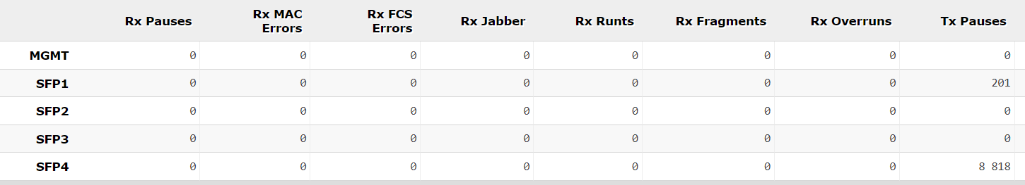

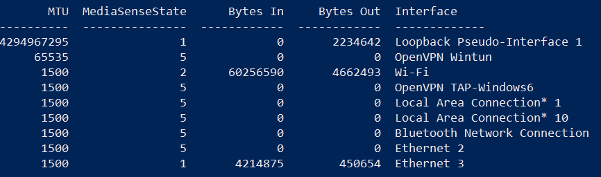

  3. Ah, I did not notice the retry count - thanks for pointing that out. The MTU on my windows machine is the standard MTU (Ethernet 3 - 1500): I also confirmed in Unraid that it is set to the default MTU in the network settings, which I also confirmed in the syslog. I can see in my MikroTik switch that there are Tx Pauses, which I'm assuming is a symptom/cause of the retries: Could this also be a problem caused by the switch? I guess its also possible that its a bad DAC SFP+ cable, I don't have an extra one to try on hand but I could get one. Thanks for the input 🙂 - John

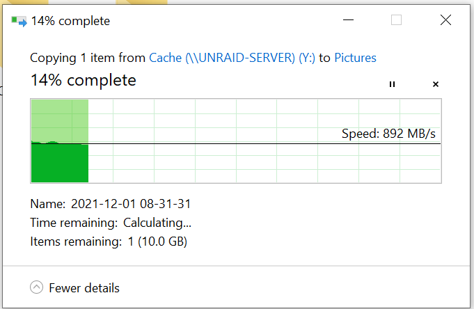

  4. Hello everyone! I recently attempted to upgrade my Unraid machine to 10gbps networking. This is the card that I bought off of ebay: https://www.ebay.com/itm/164688767051 (Screenshot in case the listing is taken down) Originally I was super impressed with the write speeds, I only have a 2.5gbps network adapter to test with and I'm getting almost the full speed. I am using an SSD cache-only share to test this: But the read speeds are very slow, slower than a 1G connection: At first I thought the issue must be samba or my local windows 11 install, so I tried SFTP and got the exact same results, writing to the array is fast, reading is slow. After about 6 hours of debugging, I was able to figure out that the cache is performing just fine and I have narrowed it down to the network card. Running iperf3 on Unraid gives the expected results when Unraid is the server (again the max speed I'm expecting is 2.5Gbps because of my network adapter): When I set Unraid to be the client, I get the very slow network results: However, what is strange is that when I connect to the Unraid machine from a computer running with a 1Gbps card, I get the full 1Gbps speeds both in Samba, sftp and in iperf3. Extra Details: The Unraid machine and my test client are connected using a MikroTik switch: https://www.amazon.com/MikroTik-CRS305-1G-4S-Gigabit-Ethernet-RouterOS/dp/B07LFKGP1L The MikroTik switch is set to SwitchOS mode, I have also tried RouterOS mode and it performs the same. The raid contains 7 hard disks, 4 SSDs, 2 of the hard disks are parity disks Things I've tried so far: - I put the Solarflare network card into another desktop machine running Ubuntu 18.04 and it was able to perform the iperf3 test at the full expected speed. This makes me think the card and the switch are working as expected. - Swapping the PCI slot that the network card is attached to - The Unraid server is connected to the MikroTik switch using a DAC SFP+ cable - The test server is connected to the MikroTik switch using a 2.5Gbps to USB-C network adapter => CAT6 RJ45 cable => 10gbps RJ45 transceiver, I have swapped out the CAT6 cable for other cables and it has had no effect. - I have upgraded the firmware on the Solarflare card to the latest available. This was done using the solarflare firmware update tool available on Windows. I have also attached my anonymous diagnostics, but I'm not sure if they will be much help here. I have read through more than 20 other unraid posts complaining about a similar issue, but I wasn't able to find a solution to this problem. Does anyone know how to fix this, or any ideas to move forward on debugging this? I have provided as much information as possible, but if you have more questions please let me know. Thanks for the help and thanks for reading, John unraid-server-diagnostics-20211211-1621.zip
