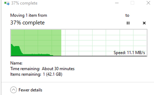

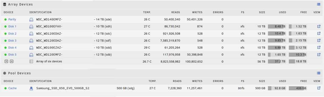

  1. I have a "download" folder on my unraid that capture various files I gather from various locations (internal and external). For example when I burn Music or DVD for Plex. Then, I want to move file from the "download" folder into specific folder, for example Movie Plex. When I cut the file from "download" and paste, I only get 5mb/s to 20mb/s... When it starts it's at 200mb/s but quickly goes down to 5 to 20mb/s Any suggestion to improve transfer speed? Thank you. Here is my set up.
