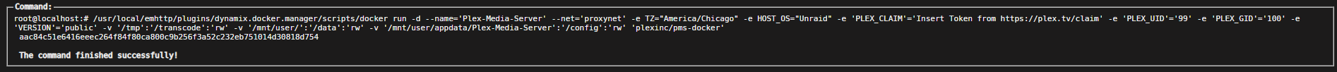

  9. That led me to the solution. Instead of being on the landing page after logging in, the setting I needed was on the individual tv show itself. I dove into using plex's live TV/DVR option a month or so ago and I thought the option to keep only x number of unwatched shows deleted what was recorded, apparently it deleted the previous files I imported and had already watched as well. Good to know. Thanks for all the help Jonathan!
  10. Update: I've been able to confirm that Plex is somehow the culprit. When I add a season folder, then force it to run it's scheduled tasks, it deletes them. I see under the alerts section of plex that it deletes the media. I disabled all scheduled tasks that could cause deletion. Unchecked the options to empty trash after each scan, and the one that allows media deletion. But when I force it to run scheduled tasks, it still deletes the media.... Any ideas? Would making plex read only solve the issue? if so, how would I go about doing that?
  11. Well I think I can rule out issues with the disk. I used the unbalanced plugin to move all of the show to a newer disk, confirmed that the files were written to the new disk and were playable. Checked this morning and all but the current season was deleted again. Any ideas?
