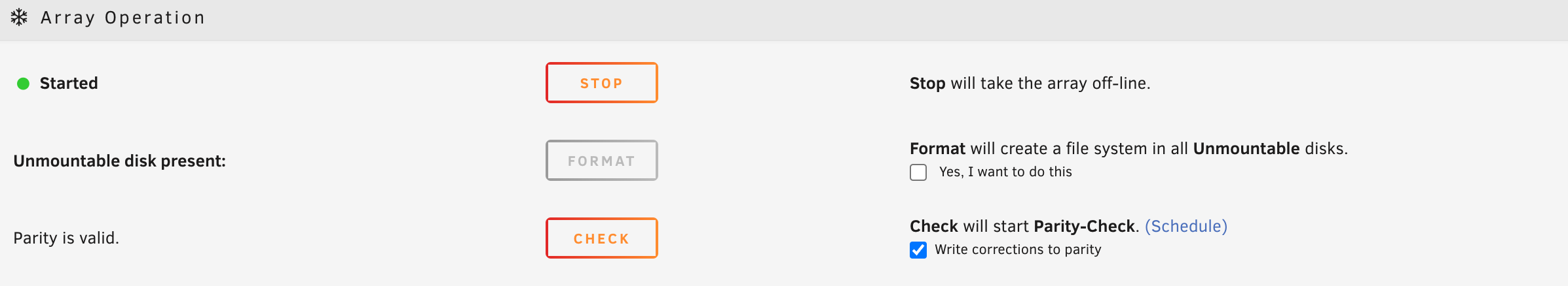

  1. It's supposed to appear something there, but it isn't. Also, the disk is repaired, but unraid can't detect it as a disk used before, it recognizes as a new disk into the array
  2. I don't think we are in sync. Are these the steps you want me to do? - Disk isn't assigned - start array - click format ? That won't delete all my data?
  3. If I don't assign, how do I format it? I'm confused...

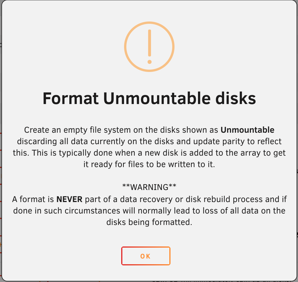

  5. You sure that it's okay to start the array with the disk in this state? I'm affraid Unraid will erase it's content
  6. Sorry but I can't find the solution in the docs. Should I start the array with maintenance mode? I'm affraid of losing data... Need some guidance

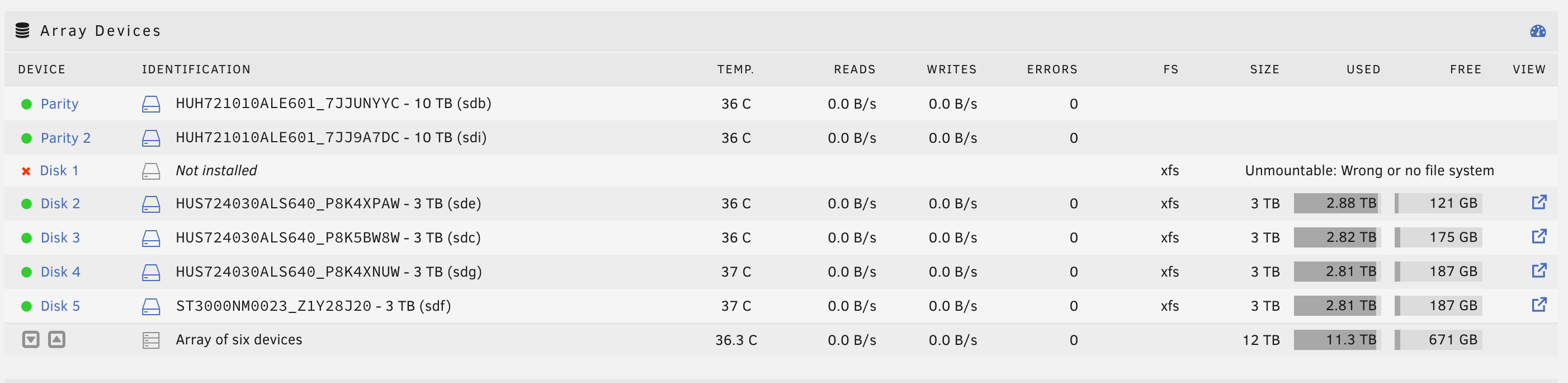

  7. I'm copying 2.8TB but I only have 700GB left on my array, can I still copy data. After the copy I'll add this disk into the array so the storage will increase. Right now the array tells `Device is missing (disabled), contents emulated`

  14. Do you mean disk2 (HUS724030ALS640_P8K4XPAW) ? That's the one which is plugged in and disabled. The disk1 isn't on the system atm disk2 is the one I want to recover data
  15. Diagnostics in attachment Parity-check is still running (1h30 left to finish) towernas-diagnostics-20231012-1647.zip
