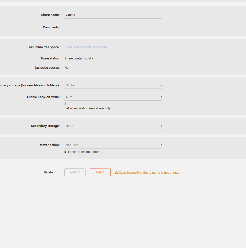

  1. Thank you for that!!!! I really do appreciate it. My knowledge of linux is just enough for me to be able to google what I want to do, but I don't have any real knowledge of what's happening in the background. Thank you again!
  2. Final update - Magic. I deleted the 2 config files after re-reading your first solution. I was then able to go in and adjust the settings and set things back up. Thank you!
  3. Update - I'm looking at the file system within Plex's docker container - it shows a lowercase "videos" under /mnt/user/
  4. Thank you - I did the clean-up thing and it said it removed 2 shares. I am looking at /boot/config/shares and I only see Videos.cfg (not an additional videos.cfg) - same thing for the other share (Software.cfg). Is it OK to delete that config file? It won't remove the data will it? I'll look through the settings on the docker images.
  5. Sorry about that. tower-diagnostics-20260205-1455.zip
  6. This is a machine that has been up and running for several years now. I've recently updated my server and now I've lost access to a couple of my shares. The share details looks really off, when compared to the other shares that have been up and running for the same length of time. The only thing that jumps out at me is that the 2 affected User Shares are using Cache for storage now (instead of Cache to Array, or most likely I had just set those affected to Array directly). Any thoughts on how to sort getting access to these shares? TIA
