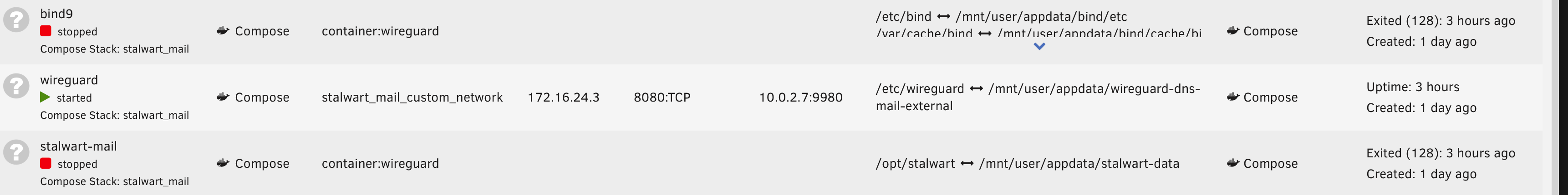

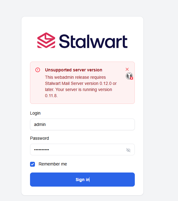

  2. Hi Mark, Just circling back after a bit more tinkering and a couple of coffee-fuelled debugging sessions. What went wrong (and how I fixed it)The culprit turned out to be a stray DNS entry in my WireGuard configuration. It stopped Stalwart’s admin UI from launching, which is why I kept hitting that 404 on /login. Removing the entry let the stack start cleanly. Because I’d already seen the v0.12 breaking changes, I went straight to stalwartlabs/stalwart:latest; the web interface is now behaving. How my deployment differs from yoursColo host with multiple public IPv4s – WireGuard runs in its own Docker container there. Inbound vs. outbound traffic – inbound mail and HTTPS hit the Unraid box exactly as in your guide, but outbound packets leave via the server’s primary IP instead of the WireGuard-mapped address. Still tweaking NAT rules to tidy that up. Odd container behaviourBoth Bind and Stalwart containers occasionally shut down and don’t auto-restart. I haven’t had time for a proper post-mortem, but Stalwart’s logs already show the first SMTP auth probes and directory-harvest attempts, so I suspect the crashes might be tied to those early attacks on the fresh install. First impressions of StalwartI really like the direction they’re heading—if the release cadence calms down, I could see myself ditching my current mail stack for this. The only piece I miss is a built-in webmail client (something Roundcube-ish), but I imagine that will appear once the new DAV stack matures. Terraform, or lack thereofI skipped Terraform because my infra is already managed elsewhere, but your repo still taught me a few neat tricks—especially around the WireGuard + AWS static-IP pattern. One open question: AWS costsCan you share a rough monthly figure for the EC2 instance that acts as the WireGuard “router”? I’m thinking along the lines of a t4g.nano/micro plus the Elastic IP fee (~US-$3) and whatever egress the mail flow generates, but I’d love to know what you’re actually seeing in practice. Thanks again for the excellent guide and the rapid updates—they saved me hours of head-scratching.
  3. After some restarts i manage to run. The error above concluded. I have changed to lastest docker image but no luck. I need to check this deeper.

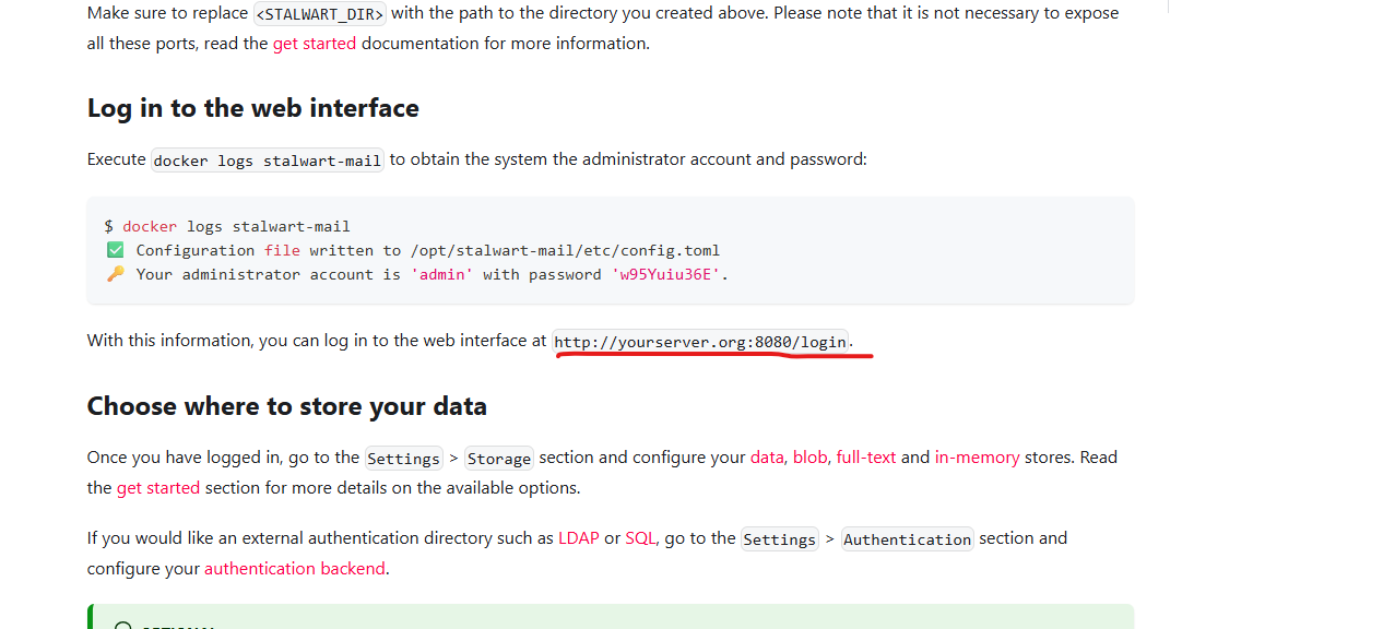

  4. Hi Mark, I'm currently testing this solution and will get back with results soon. For now, I'm having an issue with the initial login at https://domain.com/login. I get the following error: { "type": "about:blank", "status": 404, "title": "Not Found", "detail": "The requested resource does not exist on this server." } I still need to double-check everything, but according to the official documentation, port 8080 is required for login. In your WireGuard setup, only port 443 is being forwarded. On the other hand, I do see some exposed ports in the Unraid WireGuard Docker container, but there's no routing to port 8080 inside the Stalwart container. If logging in via https://domain.com/login worked for you — please share the magic behind it 😊 Overall, the solution looks solid and it should work well. Great job on the documentation on your blog, by the way! It doesn’t look like WordPress — what engine are you using? Best regards!
