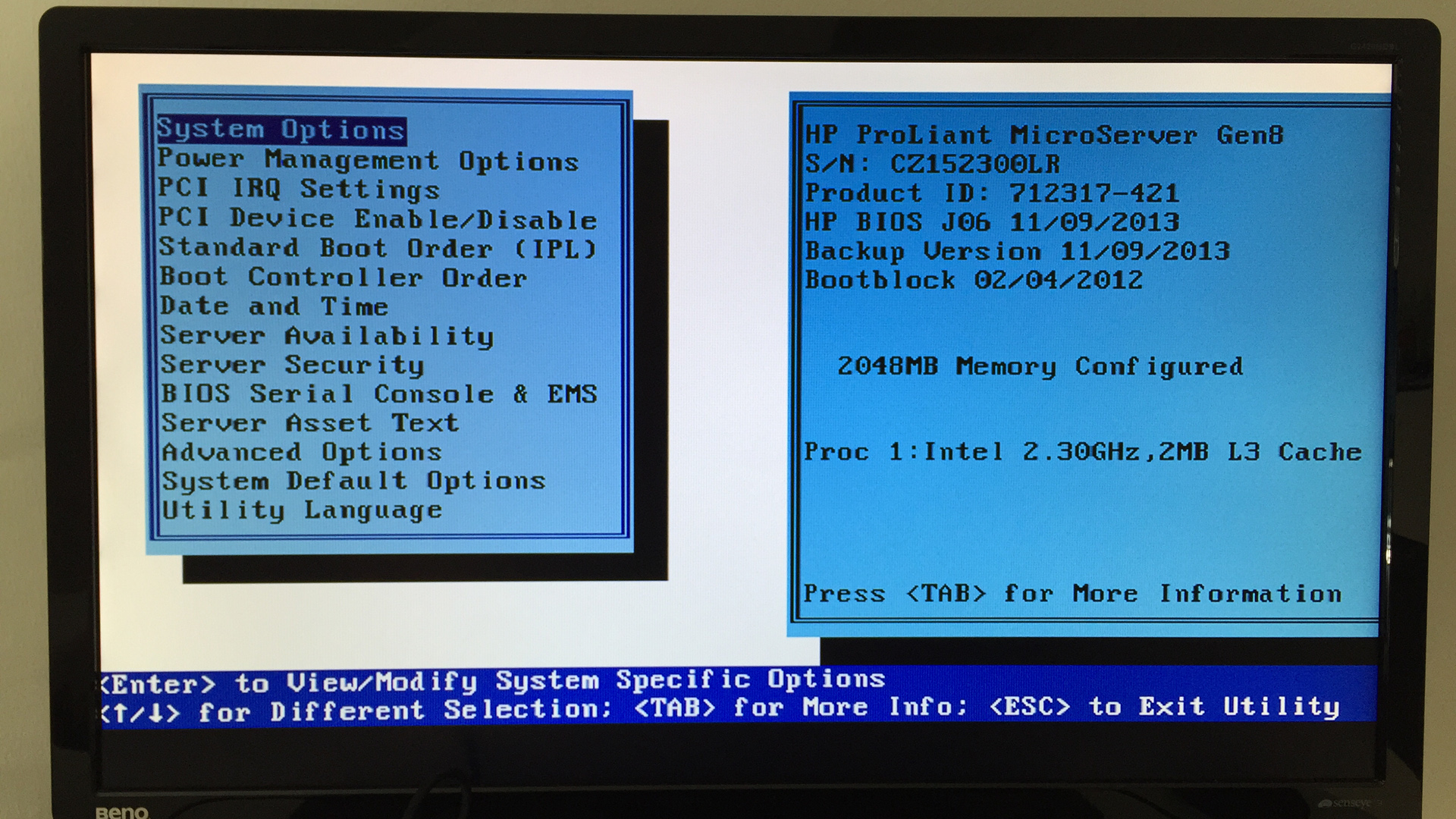

OK I've got the boot menu that looks like the pic below but where am I meant to find out if the HDD is detected?
I've moved everything back to my N40L for the time being until I get hold of a monitor but can I stick a spare HDD in a bay and boot to BIOS without anything else installed?
Damn, now to borrow a monitor from somewhere. Cheers.
I figured it probably wasn't any fault of Unraid. They're in as far as the bay will allow. How would I check they're powered?
Thanks.
