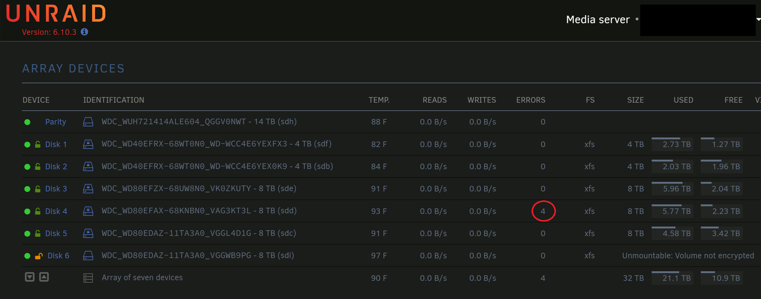

  10. Diagnostics are attached. I was getting a lot of notifications this last week. I have not gotten any additional notifications nor emails since i accidentally rebuilt the failing drive onto itself. Disregard, right after i sent this, i got a notification on disk error and the counter is at 4. I suppose that makes it an easy decision to just swap it out, and expand the storage on wednesday. I suppose i will just have to go dual parity in the future. 👍 zeus-diagnostics-20220627-1134.zip
