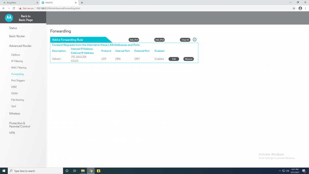

  11. Yup i can connect now both ways without an issue. Good lord.... so sorry to bother you for something so stupid. Thank you for being patient and trying to help
  12. OK..... problem solved i believe. So i got a message from my ISP last week that they were doing maintenance to the entire township and i was included in that. What i didnt know is that my IP address changed 😆. Steam seems to be able to see it both ways now. I will have a friend try to connect and see what happens

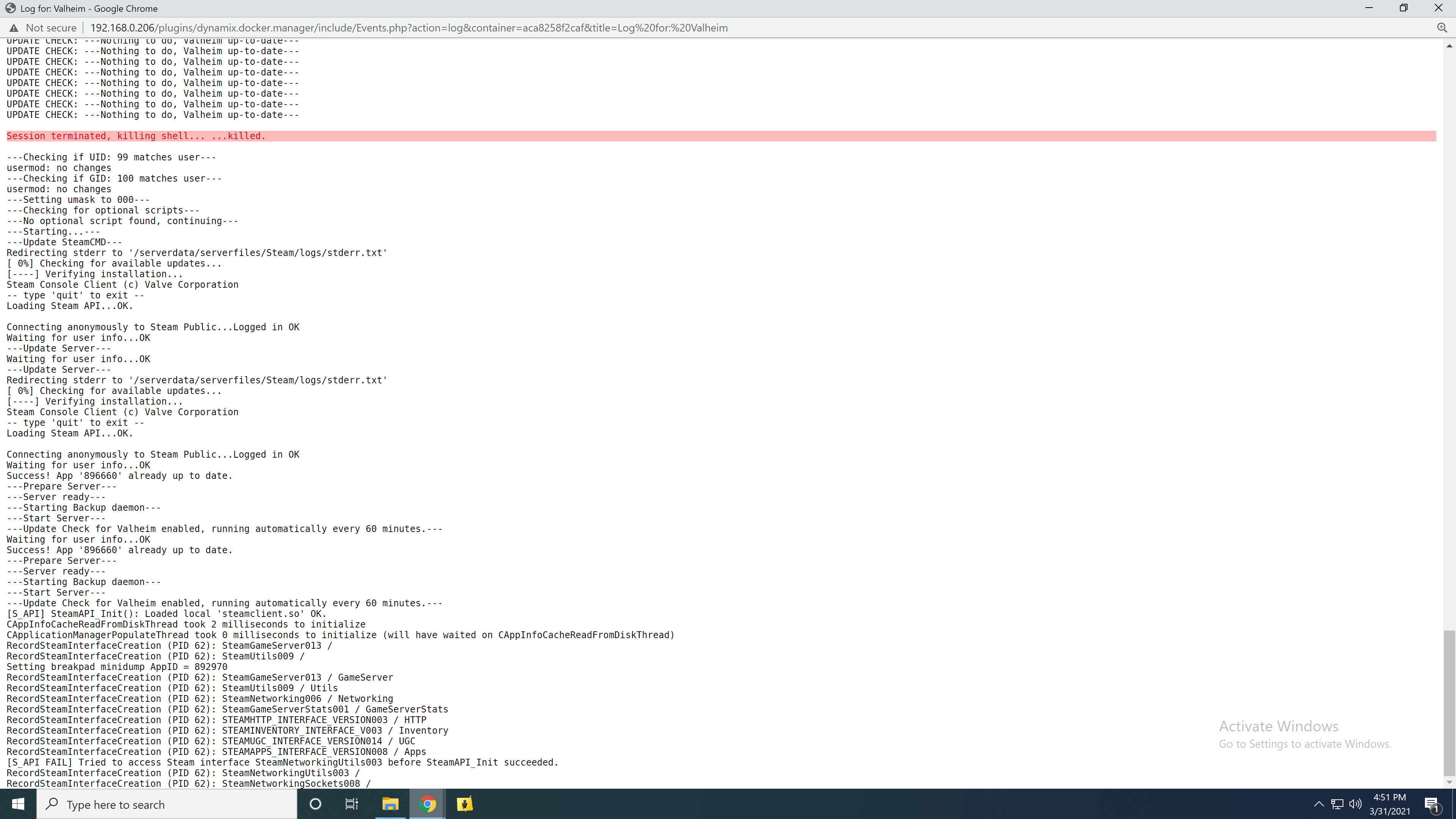

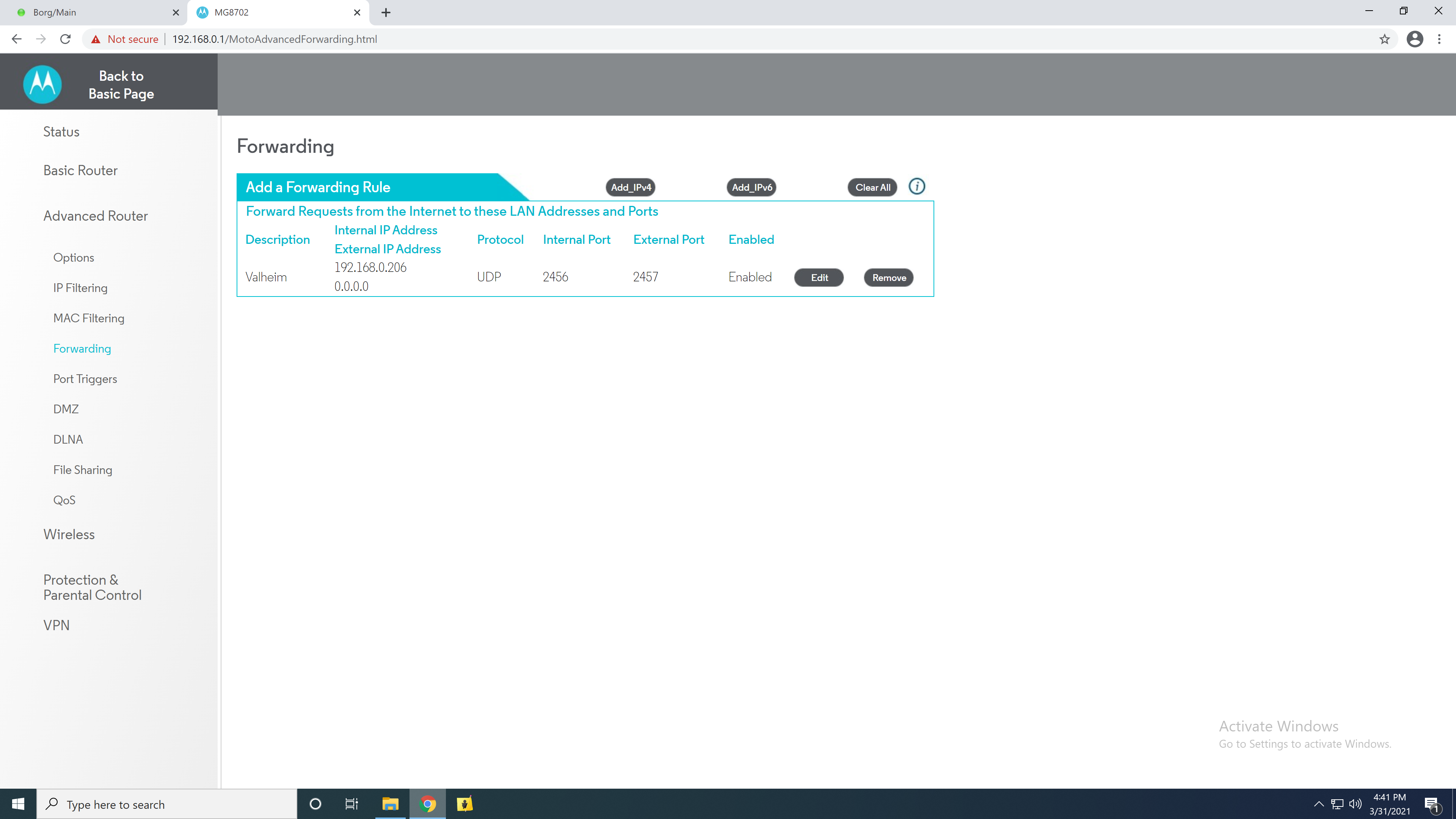

  13. Ok you are correct, I can go through the server tab in steam for the local connection using port 2457 but not externally using my IP:2456 or 7. I attached the screen shot of my port forwarding. According to my router documentation i believe that is correct but i could be wrong. I will try to add other iterations of this
  14. I see a steam connection error in the log now. Not sure how to correct that
