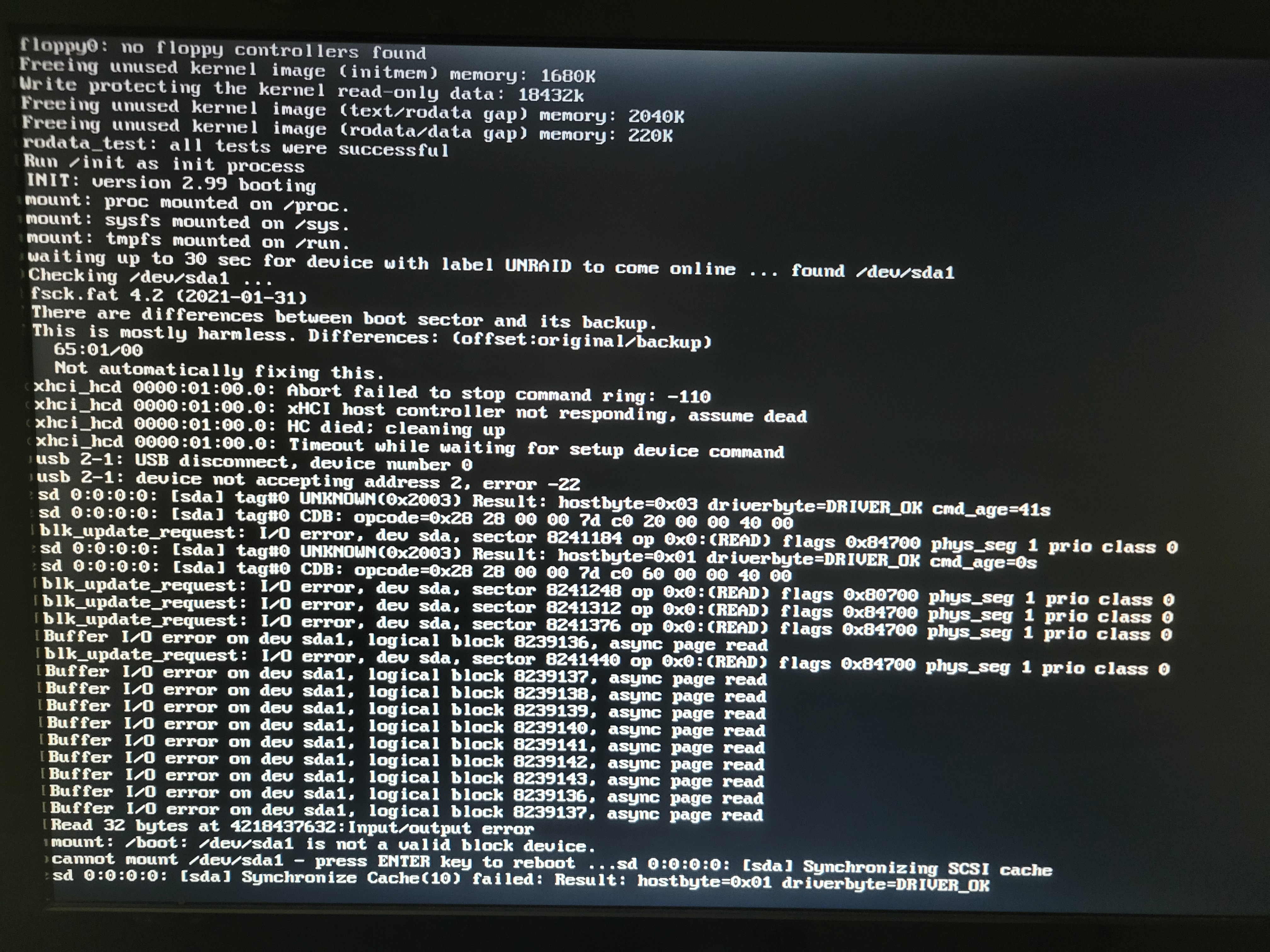

  7. So I unplugged the Drive 1 and was able to boot fine. I just went ahead and did new drive config, and checking all data. Seems I have all the data still. will run tests on that drive later in another unraid server that i have.
  8. Hi All, I don't come here much, but all of a sudden I woke up to this error. I tried rebooting, but unable to get to command line. I took a screenshot of the part it always gets stuck at. Any help would be greatly appreciated.
