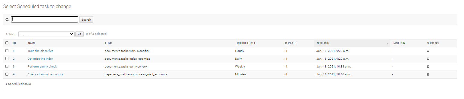

Thanks! Found it finally, made a typo in the REDIS IP that I overlooked multiple times... 🙈 192.68.xx.xx instead of 192.168.xx.xx
Is there anything special I need to do to get the schedules tasks running? I've installed REDIS (with no password) so that should be fine, but I'm not sure how to check if it connected correctly to REDIS (I don't see anything in the logs). Nonetheless, the schedules tasks don't seem to do anything, even after putting the time slightly in the future, not run is triggered:
