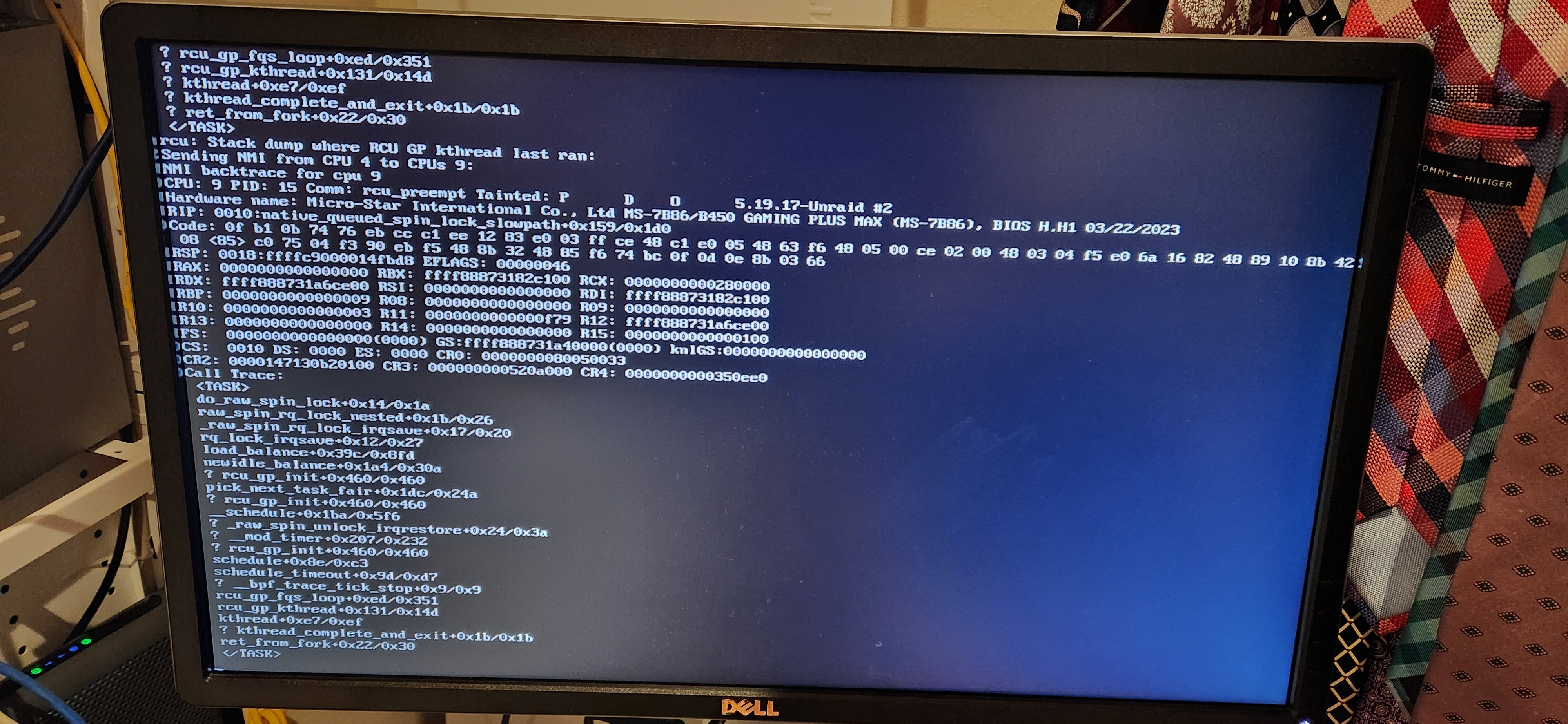

  3. I checked the thread you linked, I'm using ddr-3200 ram for a Ryzen 4600g. It's set to xmp profile 1. Bios is one version out of date, but it was the latest when this server was put together and ran totally fine for almost 2 years. The board was rock stable until I disabled c-states like the thread mentions to solve issues with USB powering down and causing coral USB tpu to fail in frigate, except it didn't help solve that issue. So I put those settings back and now these issues seem to come up every 20 or so hours. Thanks for the info @JorgeB.
  4. Last night while transferring files to another machine on the network, Unraid became unaccessible and this was the error on the screen. It keeps referencing CPU cores as being unavailable. I was also running 3 Dockers at the same time (Plex, xmrig, frigate). Frigate uses a Google coral which has been causing problems on the USB side. Diagnostics are attached, I had to reboot to get back into Unraid, these diagnostics are from that first reboot. I'm just interested in learning what causes this. While not related, I'm already swapping to new motherboard/CPU/ram hardware this weekend. Any insight would be appreciated. nas-diagnostics-20240203-0810.zip

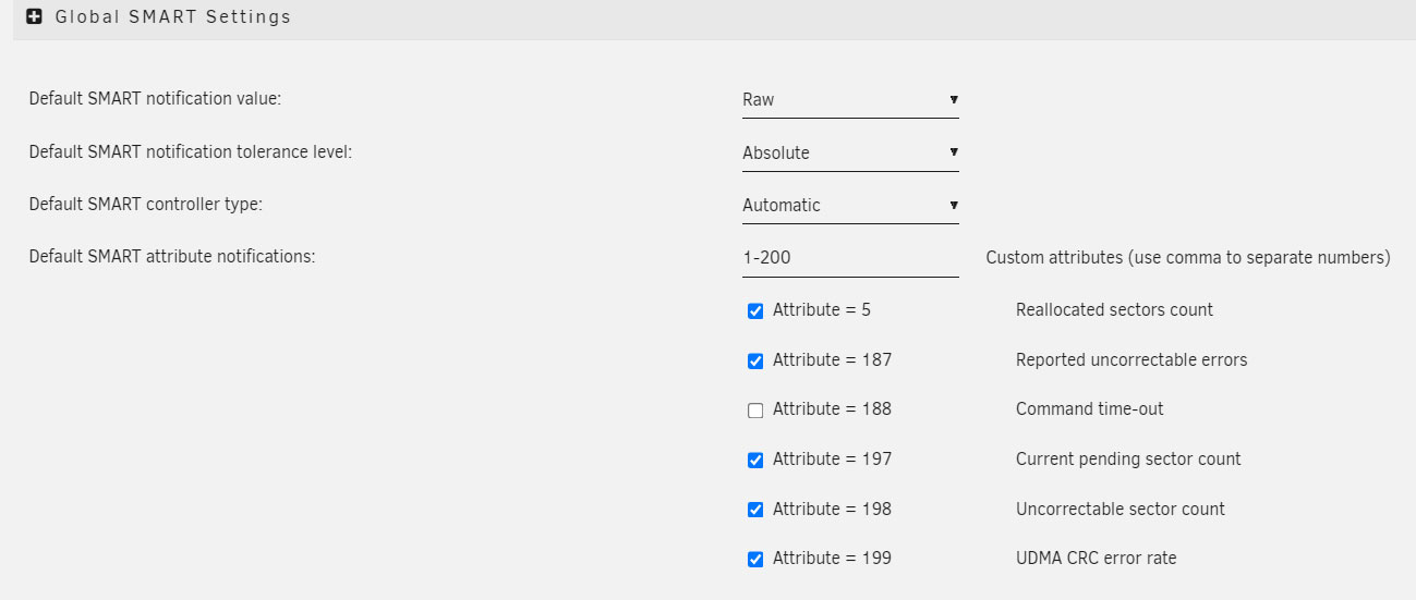

  12. I checked the other WD disks, they are all zero's on ID1, 197 and 200. Docker and VM's are set to no.
